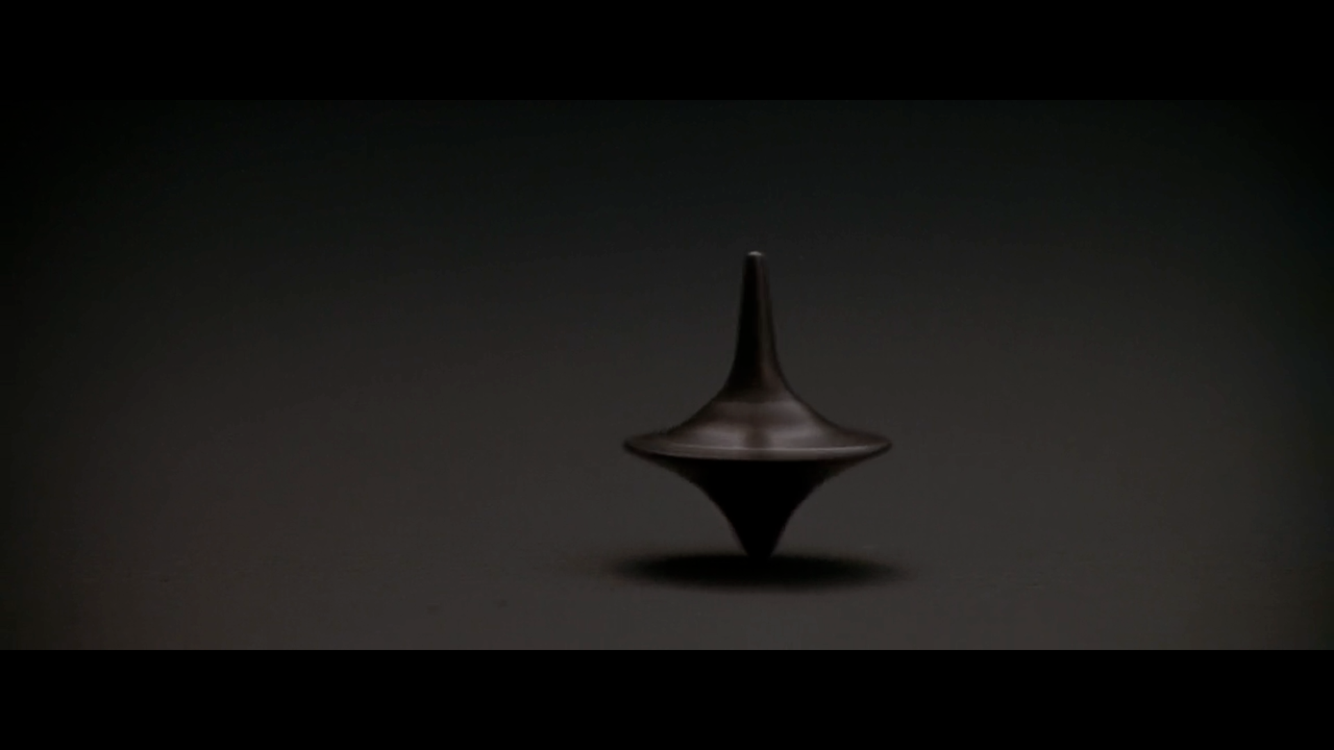

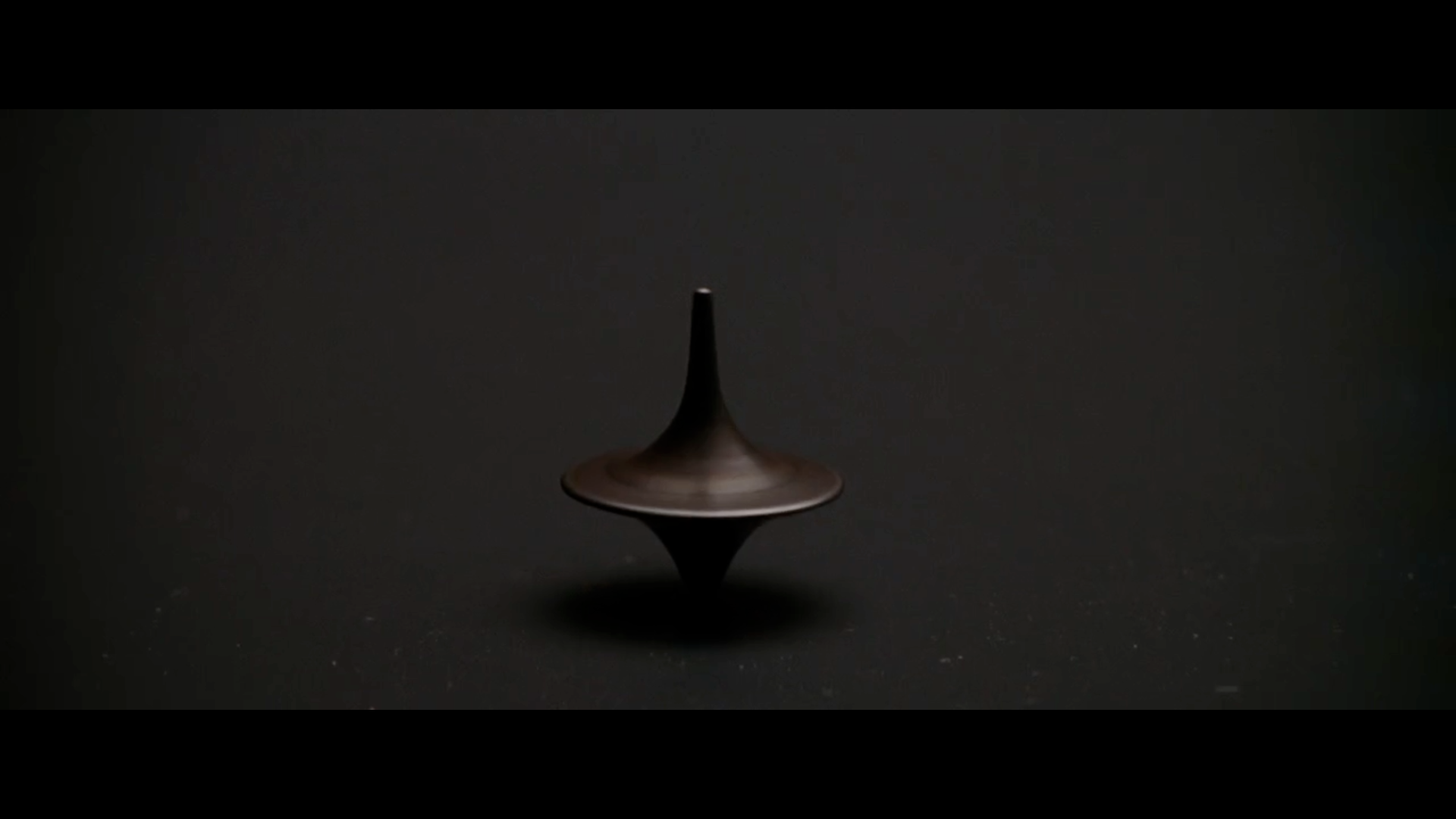

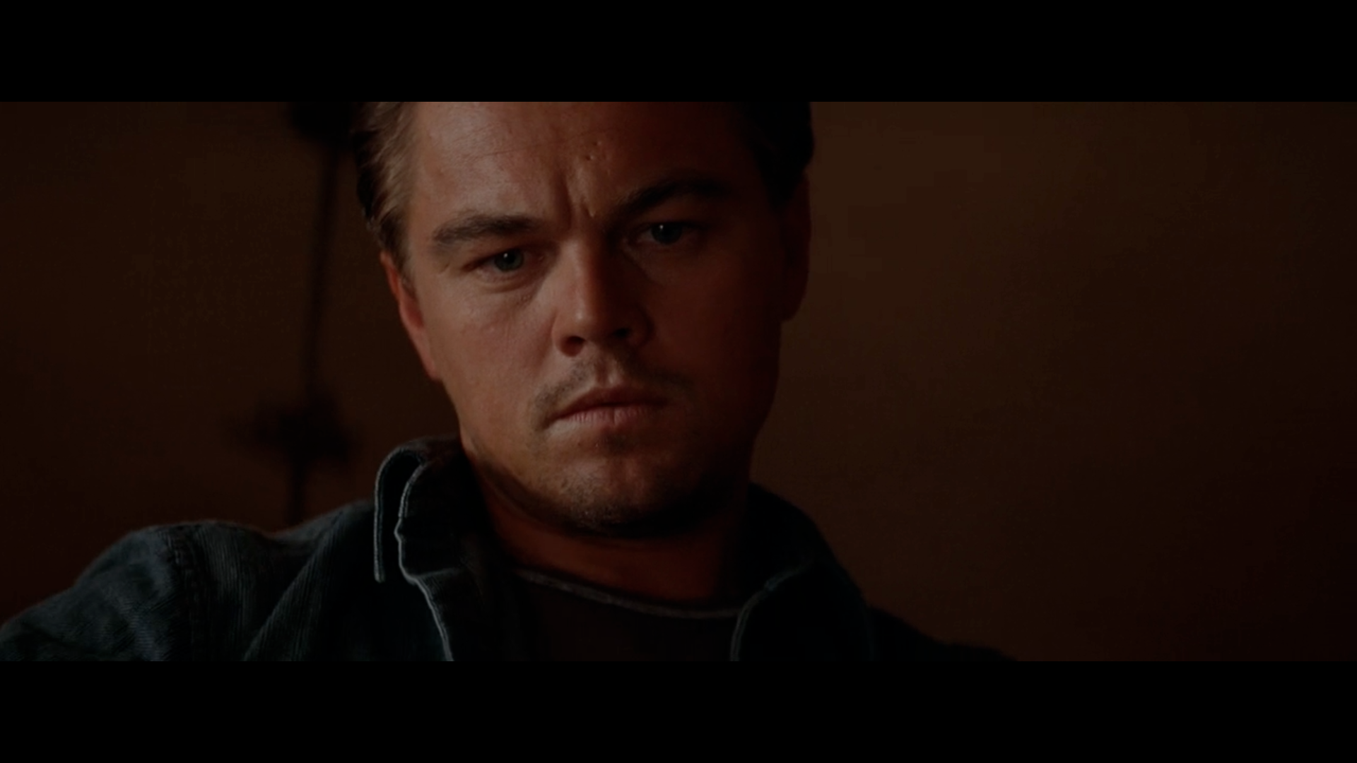

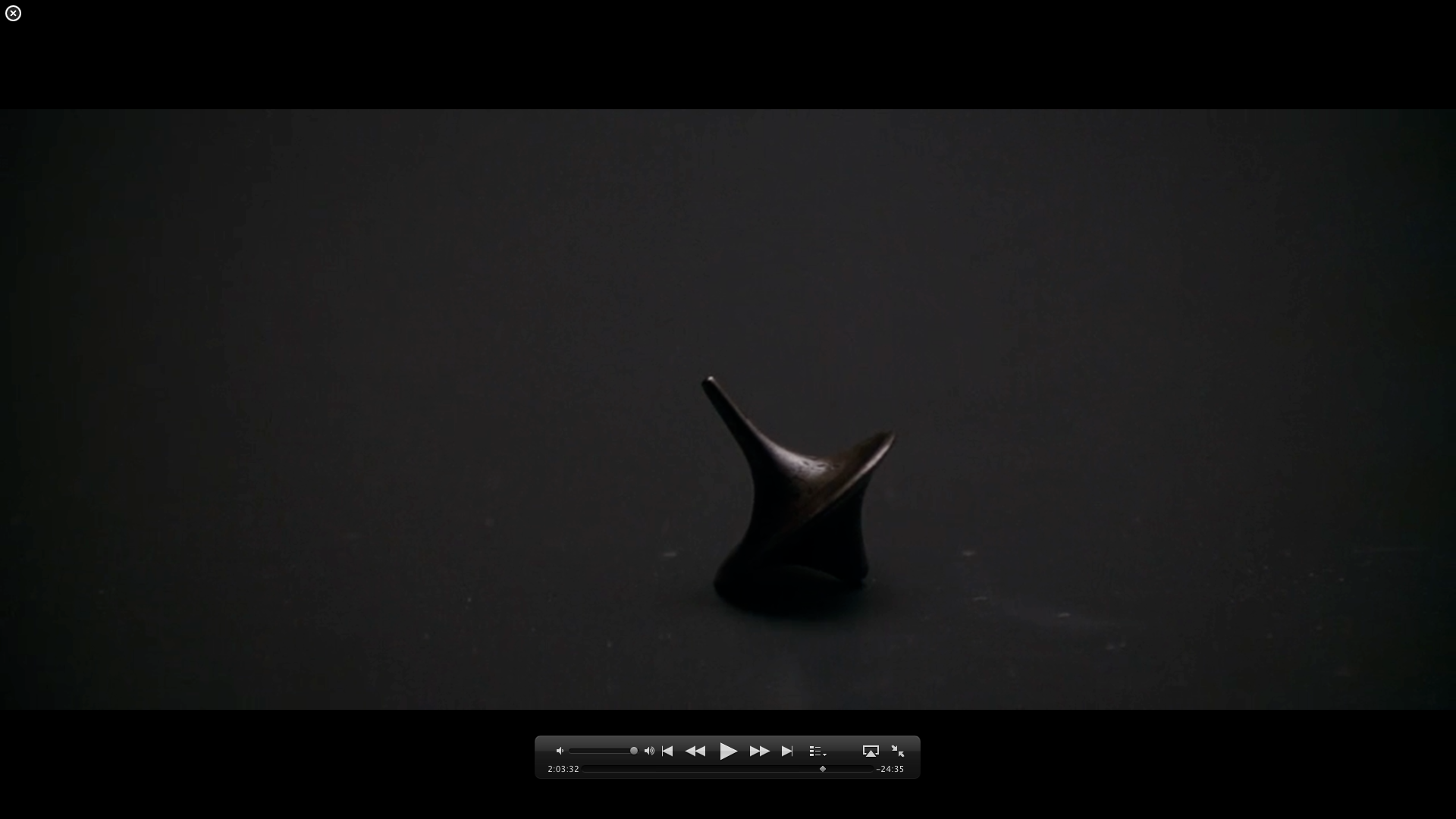

Now, when it comes to the difference that I'm seeing, here is an example.
I ripped Inception, (I'm about to re-rip it), and the quality that it is currently in, is 1280 x 528.
Now, when watching it on iTunes on my 21.5' iMac, the scene with the Top spinning by itself, you can noticeably see the pixels of the different shades of gray, basically, it's not blending well because of the lack of pixels.
So, I'm about to re-rip Inception, and hoping to see a difference in quality. Here are some snap shots of what I mean, you see how the colors not blending well because of the lack of pixels?
Again, hoping the quality improves once I re-rip it at a higher quality.
I don't think it is a problem with resolution. It looks like the blending issues may be caused by the colour depth being reduced. This causes colour bands, and pixels it show up.
So its not from the rip, but its from...my computer? How can I fix something like this? Will it look like that on a TV when using the appletv?
I am not sure how it will look on a TV. The gamma curve of your TV is likely to be different to your monitor - so this may reduce the effect.
It is something that could be corrected by adjusting the compression settings. One of the ways to reduce the size of video is to reduce the colour depth. This is why many Div X rips show colour banding, where in the origninal video it was a smooth transition.
I am only just getting to grips with handbrake, so I cannot advise what settings you need to change. It may be as simple as increasing the bit rate. If I find a solution I'll post it.
