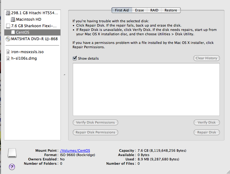

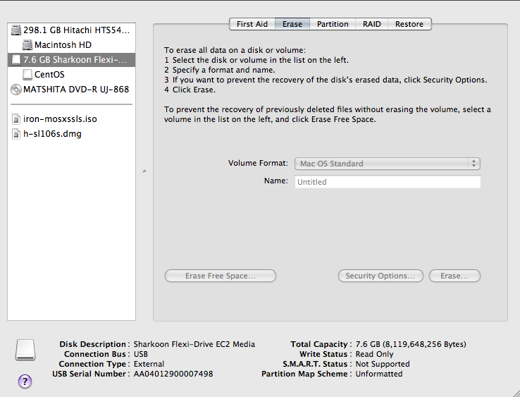

Can you post a screen capture of what it looks like when you select it in Disk Utility?
The partition options are also all grey, i cant do anything :-(

You can't write to it as it's read only. THis is strange as
attachment.php
_______________________________It says "Unformatted" and "Read-Only"^^^^^^^^^^^^^
BUt it is formatted...! (according to the sidebar...)
I have no idea. 🙁
