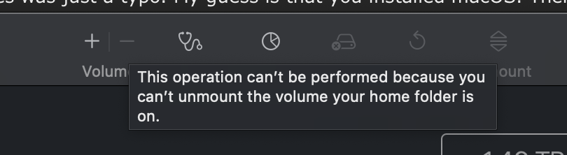

My wife spilled a glass of water on the computer the same da you replied, so we’ve been letting it dry out for a while, but miraculously it now works. I’ve gone into Disk utility & found the drive that ins’t being used (it shows 819KB of used, which I’m assuming is just how much space it takes to create the partition on the drive). But now that I n eyed to remove it, I’m not sure how to do so, There are options to ‘Erase’ or ‘Delete APFS Volume’. My instinct is that Deleting APFS volume is the right way to get rid of it, but figured I’d check here first in case that was the wrong move.
I looked online for some help, but most of what I”m reading is a bit beyond my understanding of the underlying technology and I don’t want to mess up the whole computer. Any additional help would be appreciated. Again, thanks to you & Delta MAc for the help so far.
You want the minus button here
Volume must be unmounted and my screenshot there is from the volume that runs the OS right now, but an unused volume should be unmount-able 🙂
