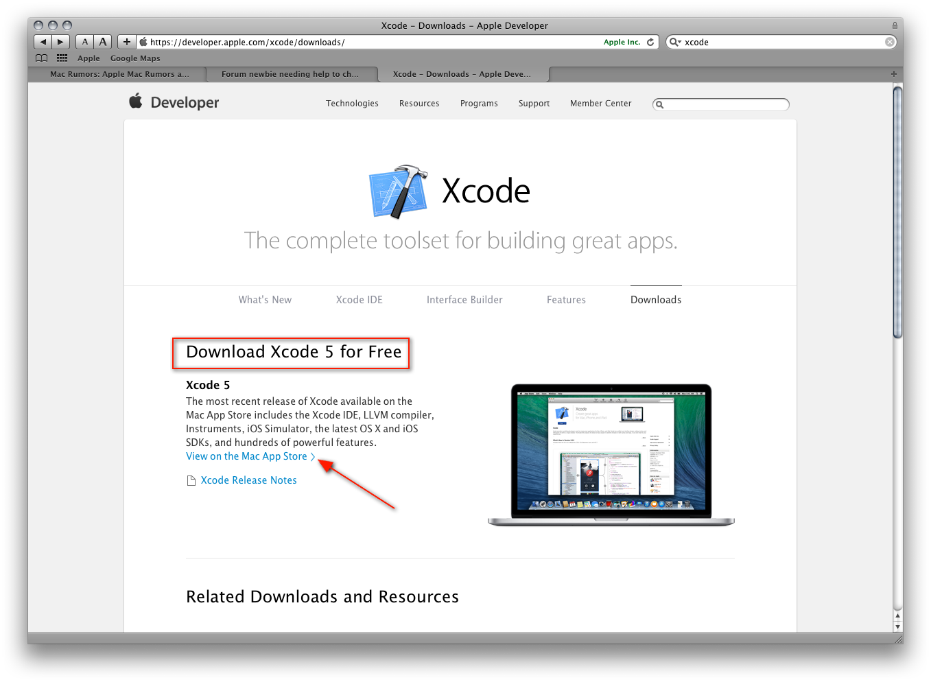

In the process of copying files from large folder on my RAID array (which has failed) I had a power outage. Most of the data had copied but the folder (on an external hard disk) has the wrong date (date now reads "14/02/1946 08:34"). I understand I may be able to retrieve this folder (and sub-folders) if I can change the date (e.g. to 14/02/2009) but that this can only be achieved by using SetFile in the Terminal. Unfortunately this is not currently loaded. Other Terminal commands cannot change the Creation date forward.
I am now reaching the limits of my expertise. SetFile can apparently be loaded if I can load Xcode from the Developers area of Apple, but I am not a developer and have limited knowledge in this area.
Does anyone know a simple way that I can load SetFile on to my iMac?
