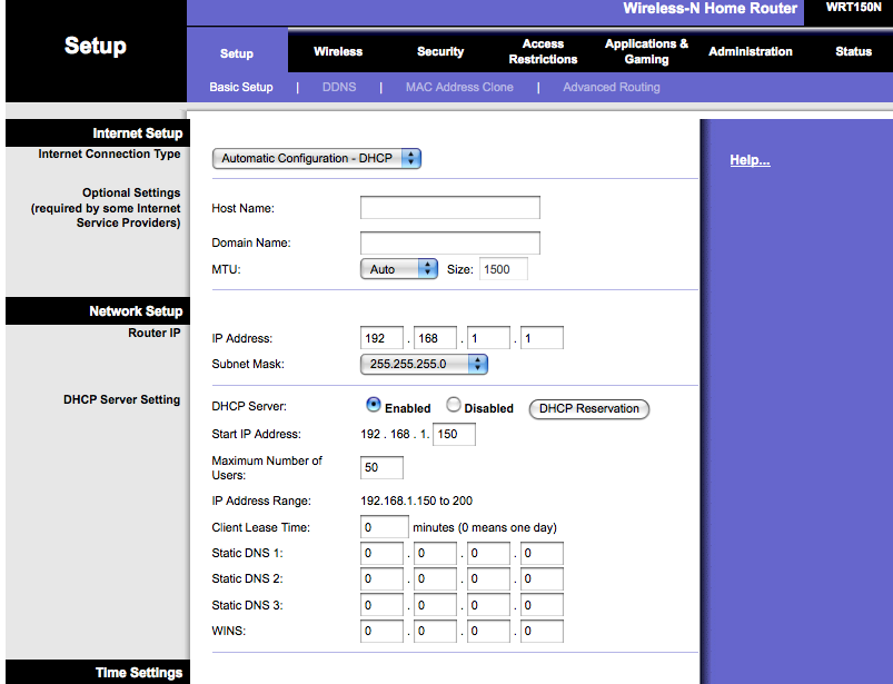

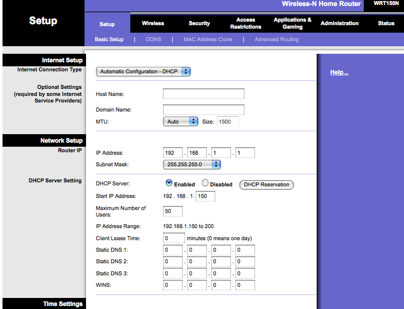

In the linksys pic, the IP address listed is 192.168.1.1 that is the router's IP, that one you use to access the router and that is also the Gateway IP address. Unless you changed that to 10.10.10.xxx then there's NO reason your macs should need to use that IP range.
below that will be the DHCP Start address...for me, I set it to start assigning at 192.161.1 (assigned by the gateway ip address above) .150
I have my xbox and my G5 tower set as static ip's below 150. So thats why I started it there.

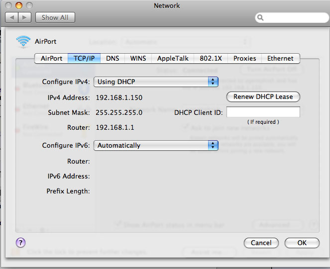

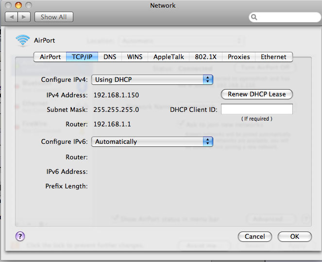

Then as you can see in my TCP/IP settings on my macbook pro, it's pulling that 150 address because it was the first wifi device to connect and I don't specify it's IP. SO it pulls that first assignable address of 192.168.1.150.
see attached.
see attached.
