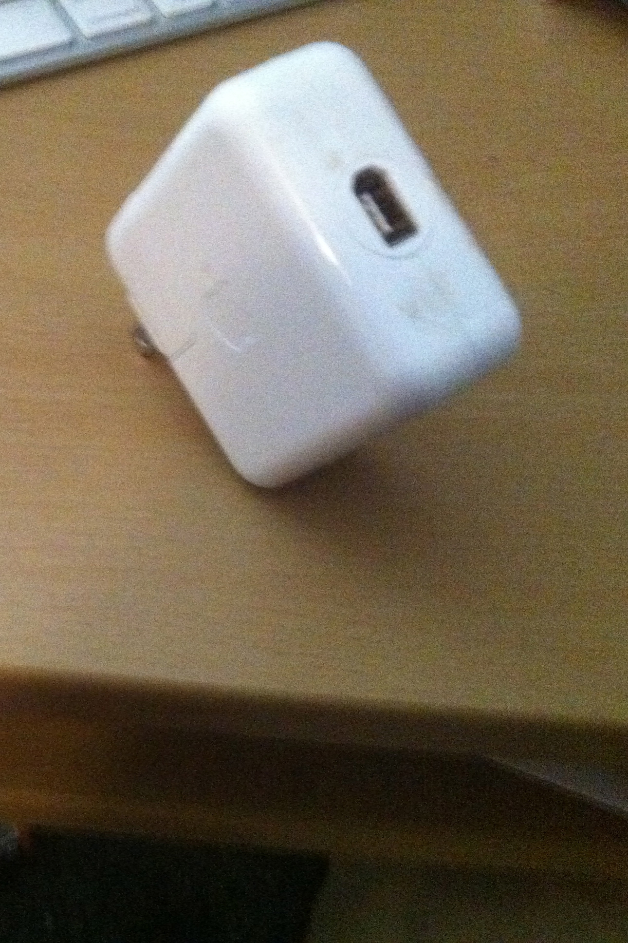

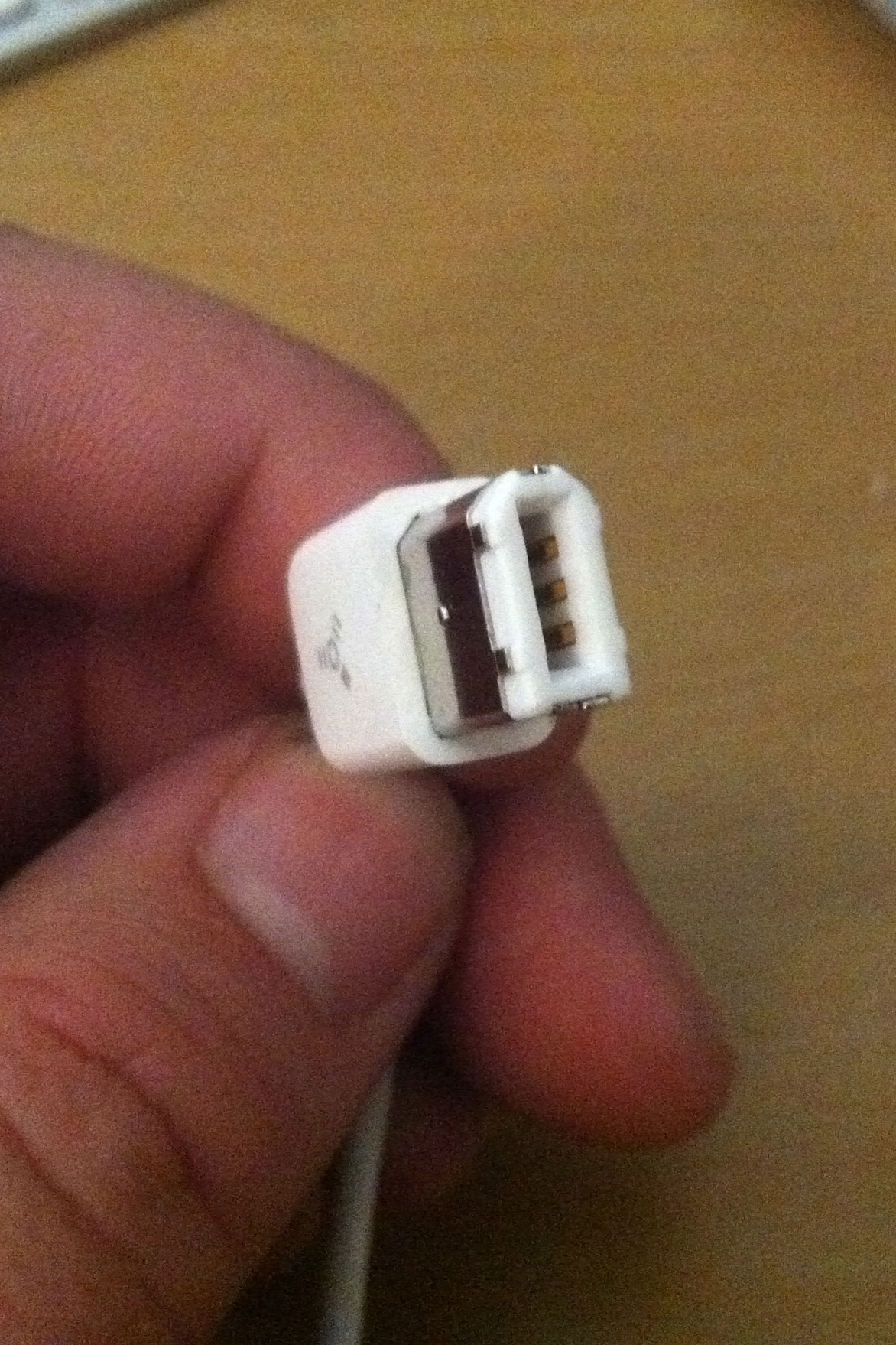

ok I'm doing the dreaded cleaning my closet out and i found and older power adapter with connector. i think its the older firewire style. will it work with current iPods/iphone/ipad? is it safe to use with them?

I believe that Apple dropped firewire support a before the iPad came out so it probably won't work with anything newer. To the best of my knowledge plugging it into a device that doesn't support firewire charging won't hurt it so give it a try.
nope it doesn't i get device not supported.
oh well.
That connector is 12V, not 5V like USB is why it won't work. Apple used different pins so things won't get damaged, but it won't work...
Belkin used to have a 30-pin to 6-pinFW adapter. We used it for an iPod mini that supported FW, but came with USB cords. The computer we used at the time didn't have USB2, but had 4-pin FW.
At the very least, keep that FW cable. You don't see the "thin" cord FW cables too often anymore.
Supported iPods with FW charging:
Classic up to 80GB and 160GB 6th gen (not the current 160GB or the 120GB)
Nano up to 3rd gen (fat nano)
iPod Touch 1st Generation
Anything later than that has had FW charging removed and only can use USB.
