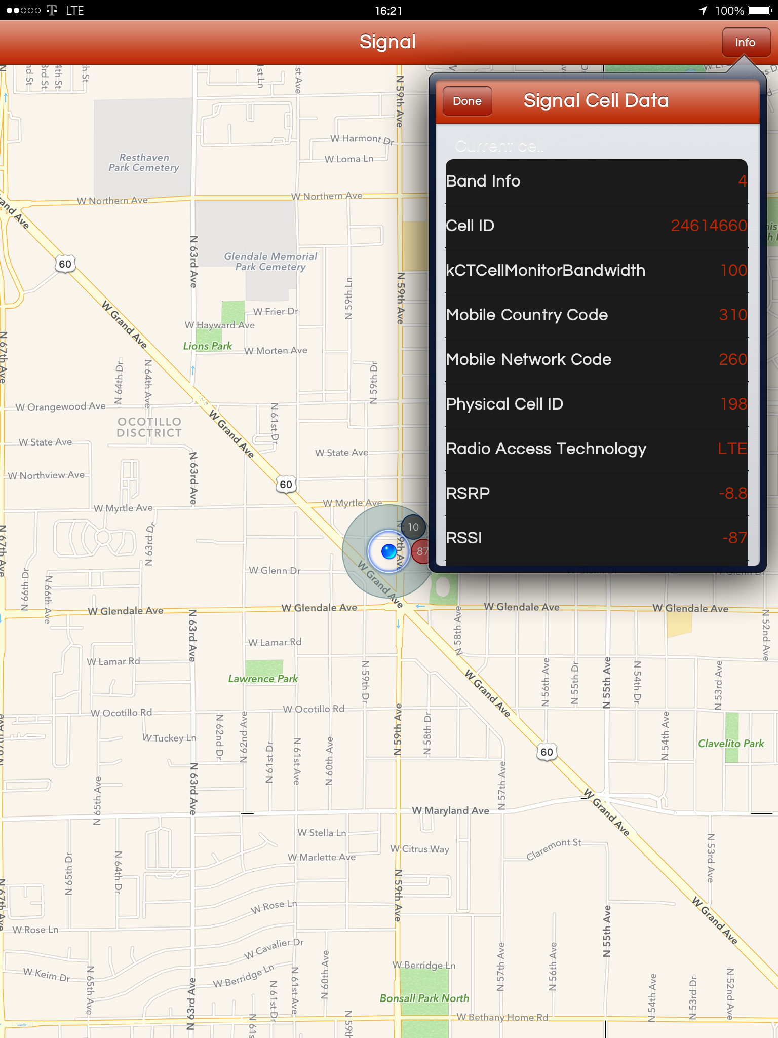

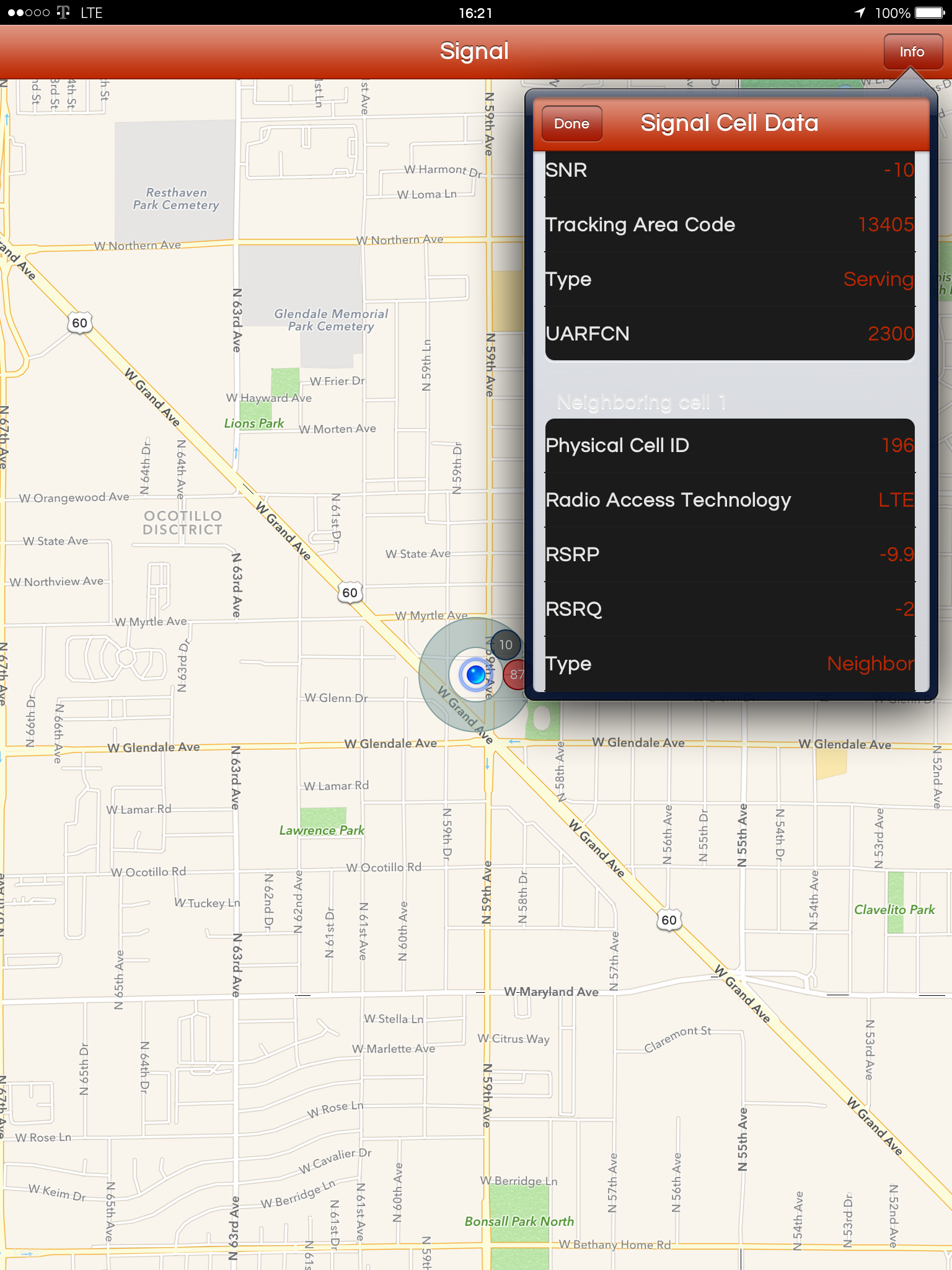

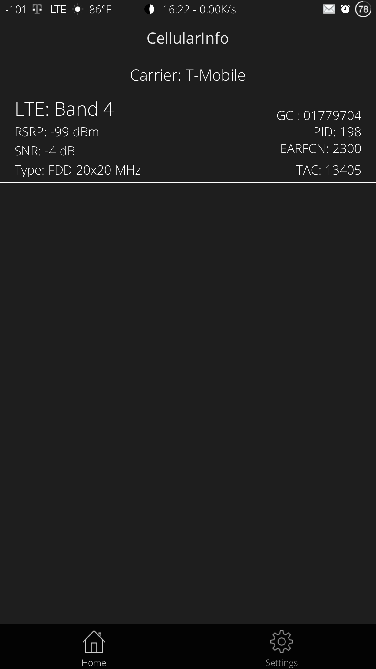

There's a couple of jailbreak apps that make this much easier. Unfortunately, only one continues to function on iOS 9. But I have a jailbroken iPad on iOS 8 so it works on that.
