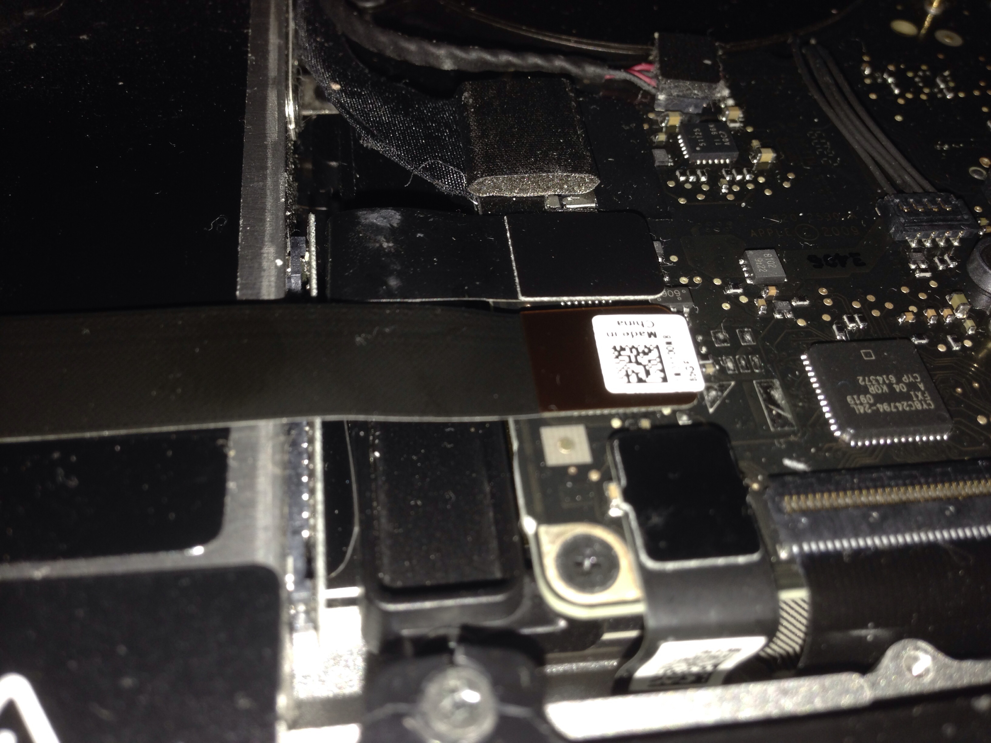

If you could, posting pictures of the cable port might help figure it out. But as your last cable fixed it until now, and the cable has not been replaced these 4 times, only reseated, I think it's the cable.

Here's an attempt at a photo of the hd cable where it connects to the logic board. I tried to press on it last night to reseat it to no avail. Seems it's actually failed this time.

does the screw mount of the battery seem broken to me? the one besides the warning cable?
if u zoom in it looks as if some ics or something have been taken of the solders can someone confirm this?
The screw mount is indeed broken. I noticed that when I opened it up last week. Could that be a sign of swelling? My trackpad is fine, but I do have the service battery warning. I'd show a screenshot of coconut battery, but I can't boot the machine right now 😛
What is ics? Is that something I should be worried about?
ics would be like fuses i cant be sure if anything was there or not unless i see a pic of a similar board. If its missing it can possibly cause problems, fixable if you can source them and find a good soldering person.
The mount being broken might not be a sign of swelling but could be a sign that someone might have over tightened a screw or maybe dropped your battery while removing it out for diagnosing.
