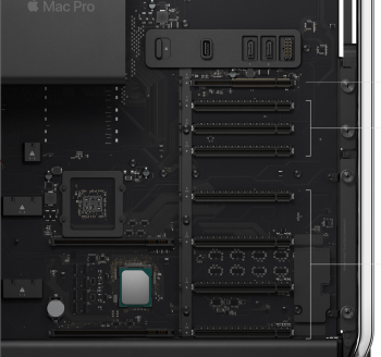

So, if the cost of the Vega II Duos is crazy expensive, like it might be, I've been considering going with four AMD Radeon VII GPUs. There's room in the tower for them, but what about power? From what I can tell, there are two pairs of 8pin connectors with each pair supplying 300w, which is the power requirement of one Radeon VII.
With 75w from four slots, plus 2x300w, plus 75w aux, that gives us 975w useable power.
So are we limited to 3 powered GPUs?
From the pictures it certainly SEEMS like there are four 8-pin power labeled for slots 1, 2, 3, and 4 and one 6-pin or 8-pin for slots 5-8. Theoretically, this should be able to power 5+ GPUs, depending on your GPU's power requirements. With four straight x16 slots, it may block slot 6 when in use.
Not 100% clear if it's going to be limited to ONE 8-PIN PER PCIE (1, 2, 3, 4) based on the labels on the images. Also not 100% positive if there is an "activation" required to enable, or if there is a requirement for a card to be physically present, such as a card in slot 2 in order to use the allotted slot 2 8-pin. Those are the types of details we're likely going to need to wait for answers on if you're not planning to use the MPX.
That's from the MPX slot. An off the shelf GPU won't connect to that unless someone makes an adapter from the MPX slot to dual 8pin or something.
They said there are 4x 8Pin PCIe power plugs available (PCIe 3.0 spec not the higher wattage PCIe 4.0 one)
That extra one at the top is maybe a 6-pin for powering the Afterburner ASIC?
Unless Apple's film animation and pictures of the Afterburner card is deceptive, there is no aux power. It is pretty clear there is no substantive fan/blower on the card not does it have a "tall fin" system like the MPX modules. It is a simple, single wide card. It only does one thing so 75W is probably pretty good. It may be a bleeding edge FPGA from Intel/Altera since Apple bet on them for major portions of this system. That wouldn't be cheap, but doesn't need tons of thermal headroom.
I know "wait for Navi" is a bit thin but there could be some cards that take just one 8-pin. That would mean 4 GPUs. When Apple will deliver drivers for those may not be until 2020, but eventually.
Two Radeon VII now and upgrade to four Navi later would probably be ok.
Looks like 2 sets of 8pin. 300w per set. Most powerful gpus use two 8pin each.
Alternatively, each MPX bay can support:
One full-length, double-wide x16 gen 3 slot and one full-length, double-wide x8 gen 3 slot (MPX bay 1)
Or two full-length, double-wide x16 gen 3 slots (MPX bay 2)
Up to 300W auxiliary power via two 8-pin connectors
Guess I interpreted it the wrong way
