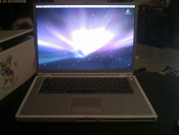

I've received the box, and set out to work. I removed the screens and boards from both laptops. I used a heat gun to remove the 'Terminator' hinges from the 400MHz screen (sadly damaging the polarizer, oops) and installed them on the 867MHz screen. I swapped logic boards, and carefully began reassembling the laptop. Thus, inducting FrankenBook ver 2.0, the prequel, into the world. Some say the original is better 😀
On first boot, I noticed the L3 Cache wasn't present, bummer. @LightBulbFun did a lot of impromptu troubleshooting to help determine the issue, which turned out to just be a failure of the cache. However, I was told, since the L3 cache is BGA soldered to the Logic Board, it may be as simple as reflowing. The case was very dusty inside, no doubt a side-effect of living in Arizona.
Lastly, since I violated the glue with a heat gun, the hinge no longer sticks to the sides, causing it to pivot and push the bezel out. I need to get some JB-Weld SteelStik to remedy this. I'd use hot glue, but that isn't a lasting solution. Maybe Apple should have used JB-Weld instead of Titanium.

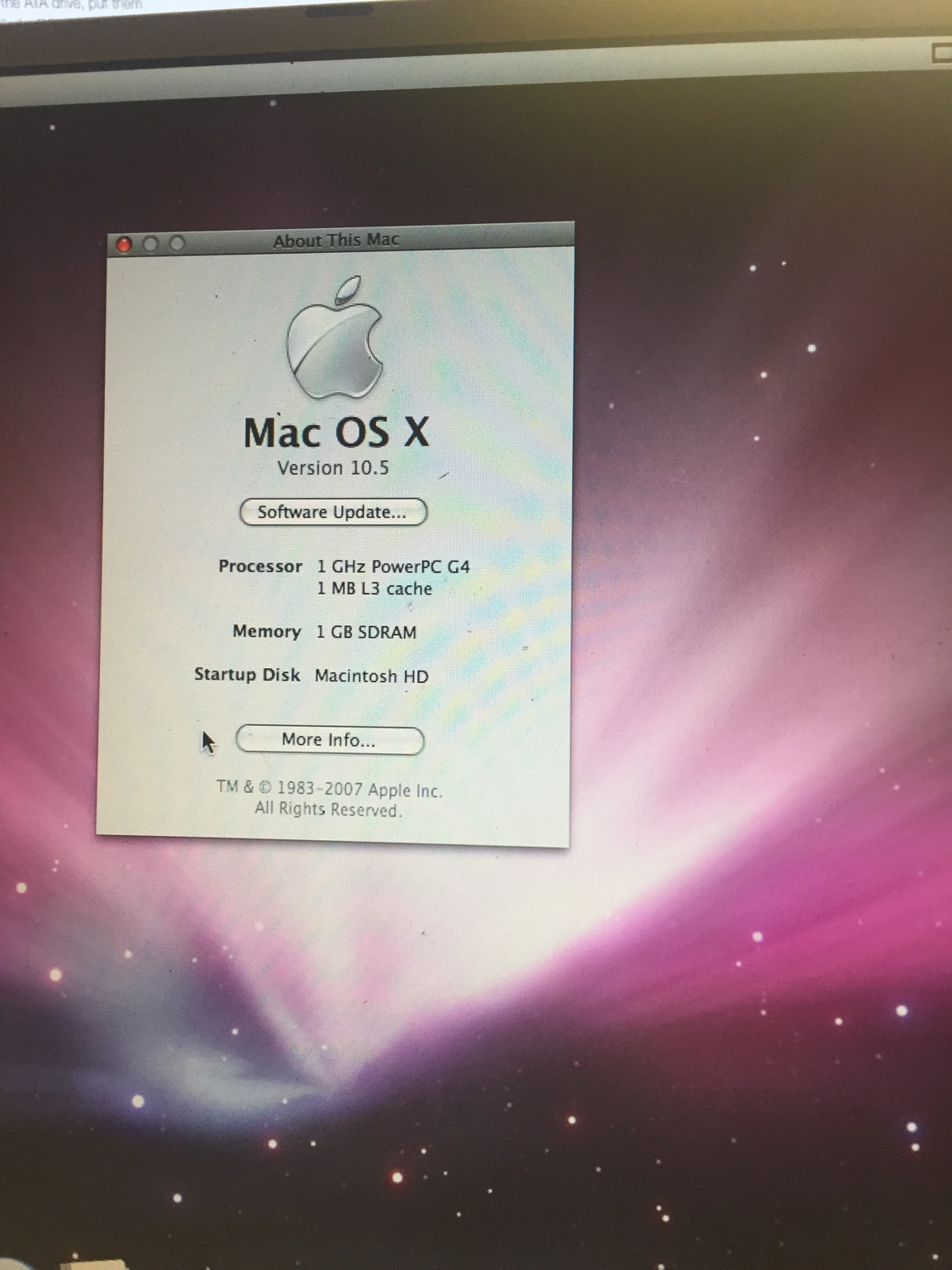

Right now, this laptop is rocking a 128GB SSD, 1GB of RAM, and 10.5.8. With the package, I also received a very nice battery, along with a Belkin card compatible with OS X. The lack of L3 cache does show occasionally, but it feels very snappy over all, but that might be the RAM. Some might ask why, I ask, why not. :apple::apple:

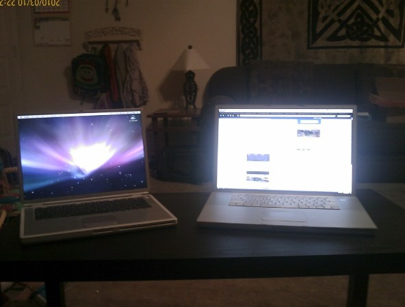

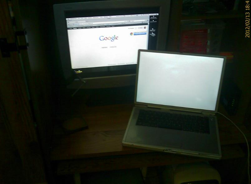

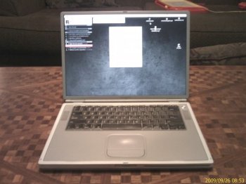

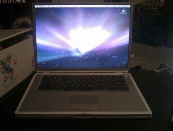

2009. Died in late October.
March 2010, rebirth.

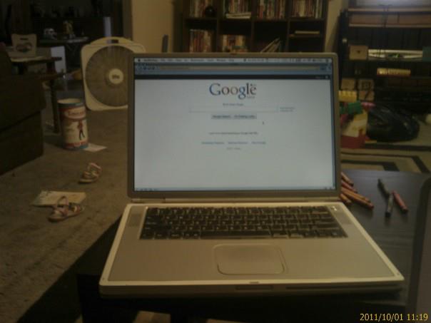

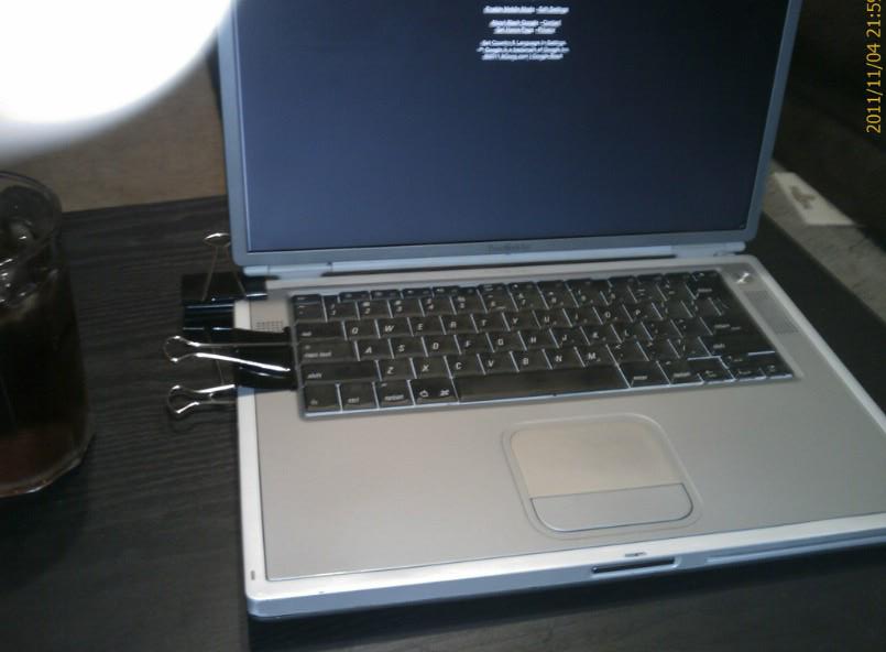

October 2011, replacement logic board is having issues after 3 year old daughter bounced laptop off couch.
The binder clips. These kept pressure on specific spots of the second failing logicboard. Which kept the Mac from freezing. Which meant it could be used.
Replacement (the Mac I sent you) with damaged hinges (the hinges you mention are from the original TiBook whose screen I replaced the broken one with).
