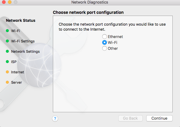

What free tools are out there I can use to check if there are networking issues like dropped packets or lots of traffic that would be severely slowing down the loading of pages to the point where it shows there is a problem on the network - see image below. I'd like to test this before I take the machine into a Apple Store to have them look at it.
The first step would be to review your entire network configuration including all attached equipment and settings.
There are several links in your connection: MBA wi-fi, router wi-fi, router-to-ISP connection, DNS, and so on. Try to verify those things that you can so you know where to focus. For example, if you can use a wired connection and it works as expected, then you've eliminated everything except the wi-fi on both ends. If, as suggested above, other wi-fi device works, then you've all but identified the MBA wi-fi. Free tools like iStumbler, and holding the option key when clicking on the wi-fi icon in the menu bar can be helpful, too.
As mentioned above, it would be best to eliminate as many things as possible before you assume it is one thing just because the timeline fits. Next time your computer is having problems, pick up another device on the same wifi network and load the same site. If it loads fine, the wireless connection between your computer and router is the culprit and we can go from there. If the separate device is also having problems, try loading a different site. If other sites work, it could be a problem with dns or could be unrelated to your equipment such as their servers being slow. If other sites do not work, you have limited your problems down to your network. If available, plug in a separate device to test your wired connection. Again, go to the same site as you are on wireless. If the site does not load, something on your network is the problem. If the site loads, you have narrowed it down to the internet connection on your MacBook. It would be best if you could test a wired connection on your MacBook, but unless you have a dongle that won't be possible.
Once you have completed these steps, post the results and we should be able to advise you better.
