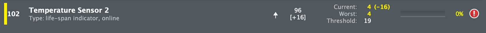

DriveDX looks fine, except for a warning on a temp sensor that looks strange to me (see attachment).

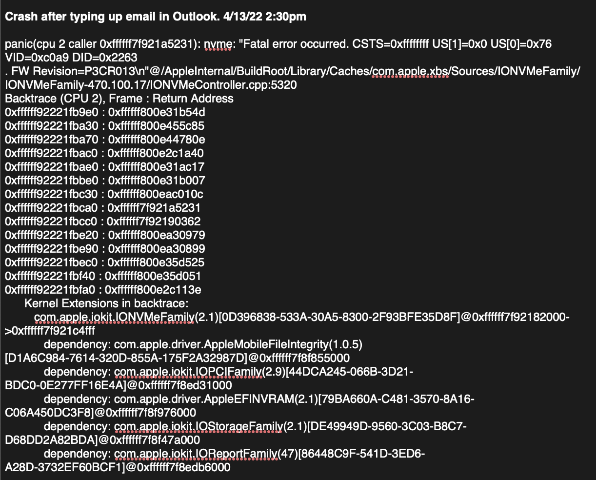

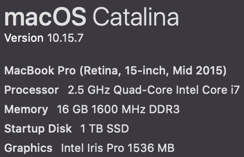

Well that makes two of us now. Getting identical crash reports every time (IONVMeFamily). Running Catalina 10.15.7 as well. Very difficult to pinpoint the root of the issue since it can happen within the first 10 seconds of booting up or 7 hours later... no rhyme or reason. I have noticed the crashes becoming more frequent, however.
When you mentioned "production" machine, what exactly do you mean by that? Because I use this laptop primarily for music production running Logic Pro X and Ableton here and there with a hefty collection of plugins (reason why I'm still on Catalina, although prob fine to update by now).
Please let me know if you've had any luck with this. Not too much floating around on the web about this specific kernel panic. Hate to say it but it's sounding more and more like a failed drive, but that's a complete guess. I'd be interested to hear how you operate you MacBook as well. See specs and abbrev. crash report below.
Well that makes two of us now. Getting identical crash report every time (IONVMeFamily).
Are you getting the same temp sensor error? I'm wondering if this may be the OS thinking the NVMe is overheating or can't make sense of the reading so just panics.
When you mentioned "production" machine, what exactly do you mean by that? Because I run this laptop primarily for music production on Logic Pro X and Ableton here and there with a hefty collection of plugins (reason why I'm still on Catalina, although prob fine to update by now).
