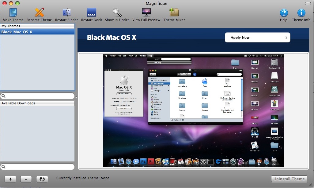

Your "friend" used Magnifique and installed the "Black Mac OS X" theme. Search your Applications folder for the app and use it to uninstall the theme. If you can't find it, you'll have to redownload the app. Also, a restart may be required to completely remove the theme.

I'm very sure he used Magnifique, see:
I'm not trying to be stubborn, I'm just being thorough.
Here's some of the files he used (still in my downloads). I feel like if he used magnifique, although I have never heard of it, it wouldn't have required so many downloads, or am I very much so incorrect?
Sorry, the picture wouldn't show.. here it is!
P.S. the magnifique download was me, it wasn't originally there. I just downloaded it.
I'm guessing you just downloaded Magnifique. Are you able to see the web history from about the time when the friend was messing with the Mac? And what are the full names of those files he downloaded.
