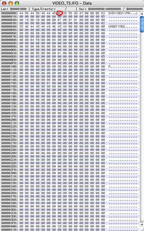

Sounds like the DVD is using Pan & Scan to make the video play at full screen, even if the source is widescreen, just by cutting off the sides. This website has some stuff to fix that. It is near the middle. Don't know whether this is still relevent, but it sounds like the .IFO file is messed up. You might want to copy the files from the dvd onto the hard drive, the edit the .IFO and .BUP file with HexEdit to change the circled value to 4E (see attached picture). Then you need to re-image it (i think), you can use ffmpegX for that, its under tools > img.
P.S. I think this would work, but I would keep a backup of the normal one first
