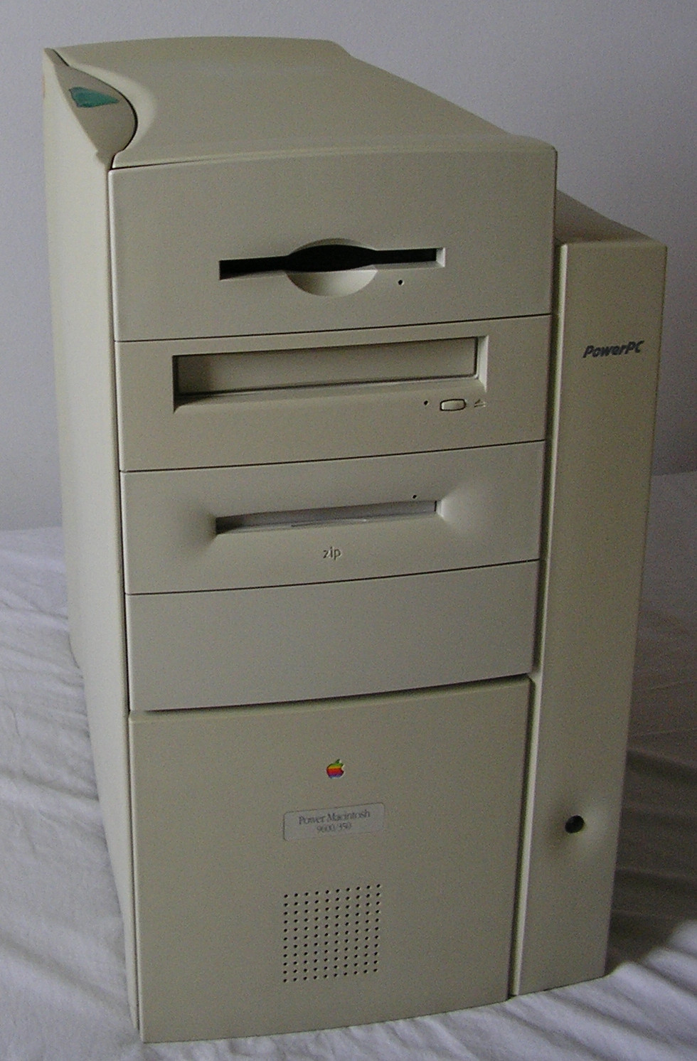

Obviously neither of you never had to deal with a recall issue prior to Apple officially recognizing the recall. Or deal with Apple warranty service before Apple had retail locations. 16 week turn around time getting service on a Powermac 9600 FTL.
That 9600 last had warranty service over 10 years ago. I'm certainly one to hold a grudge, but citing an anecdote from Apple's beige years is petty. If you want to talk about recent issues regarding iPhone call drops, overheating MacBook Airs, that's fine. Apple has had retail stores for a while now, I saw my first one overseas in 2005, so I'd say they've had pretty good coverage for 4 years now, at least in America.
Honestly, if you have to cite examples of poor customer service from the 4-12 year ago time frame, that speaks volumes to Apple's excellent service.
You're picking and choosing what part of my statement to recognize. There have been quite a few recalls lately where customers were left high and dry for months until an "official" recall was started. The MacBook Pro batteries and 8800GT video cards come to mind, as does the yet solved MacBook Air external display noise problem.
