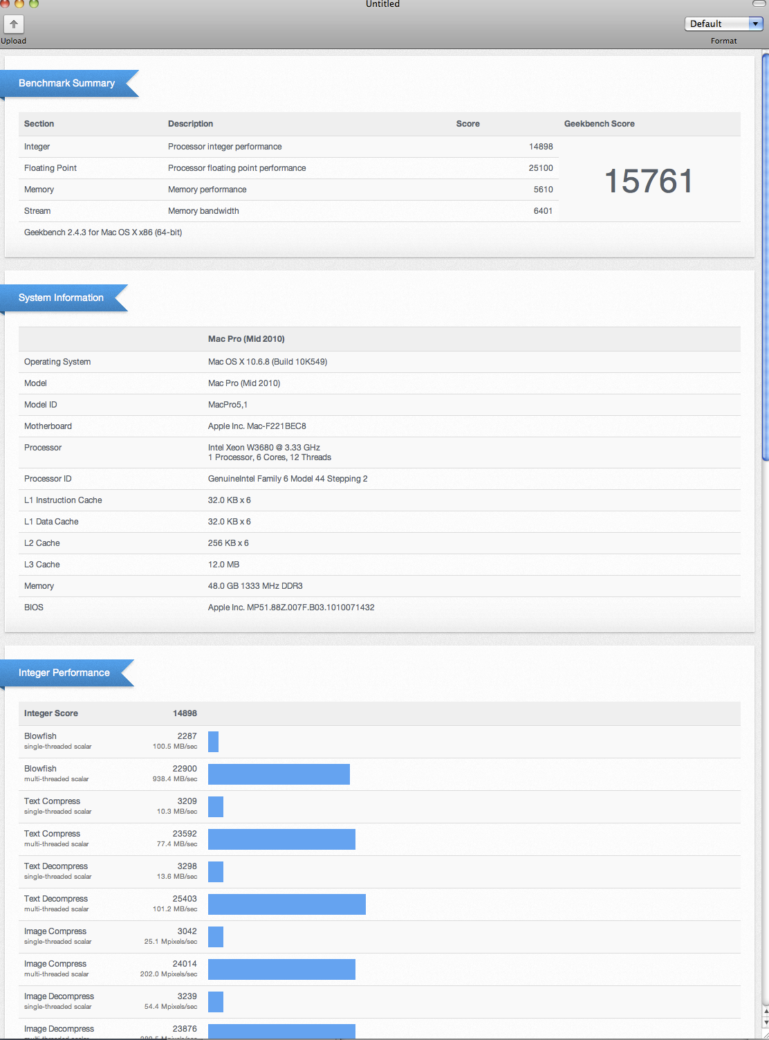

You got me curious, so I ran a geekbench on my 2010 6-core.
I win on ram, but you pretty much smoke my machine everywhere else.
(OS X 10.6.8)
I think Photoshop runs a bit better on a 6-core for smaller file sizes
(up to 2 GB) but with 96GB of ram your 12-core would probably pull
way ahead on the bigger 10-15Gb files...And I'd be awfully jealous.
Going to get the 2.93Ghz "Geeked" later,. Curious to see what she does.
My six core is using about 46GB of ram on the big PS files with bridge
and PS both open and cranking and using about 160GB
(out of 480GB on the Accelsior PCI-SSD scratch disk.)
