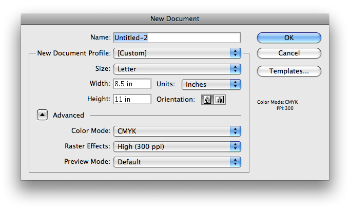

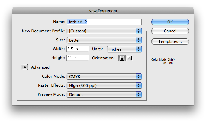

You mentioned using JPEGs in your cover art. That immediately puts up a red flag for me: Low Res bitmaps. All bitmap graphics going to print on an offset printing press should be 300 dpi @ 100% of size used in the layout. You can get away with scaling them up a little but its best to avoid it. All bitmaps should also be CMYK. JPEGs typically are RGB so there's a second red flag. The Illustrator file itself also needs to be set up properly. It should be CMYK Color Mode and Raster Effects should be set to 300 dpi. Any colors used should be spec'd in CMYK values (not RGB).

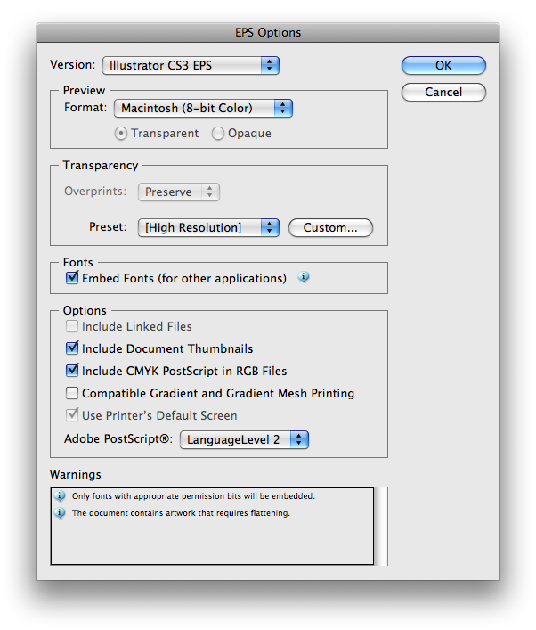

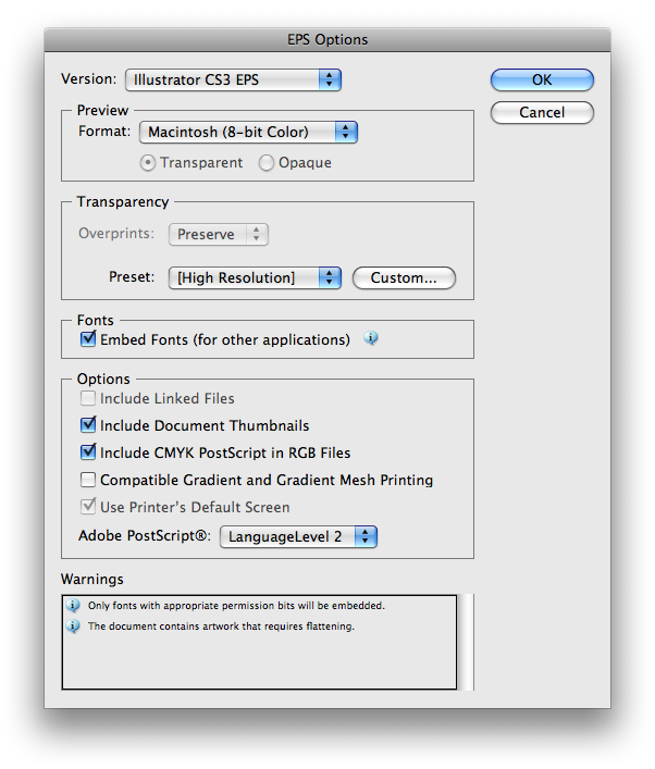

I tend to always work with a native .ai file as my working file and then when the art is ready to be placed into Quark (or preferrably InDesign) I convert all text to outlines and save the file as .eps format. I have attached sample New Document settings and Save EPS Options for reference. Since you have images placed into Illustrator, check the box for Include Linked Files in the EPS.
