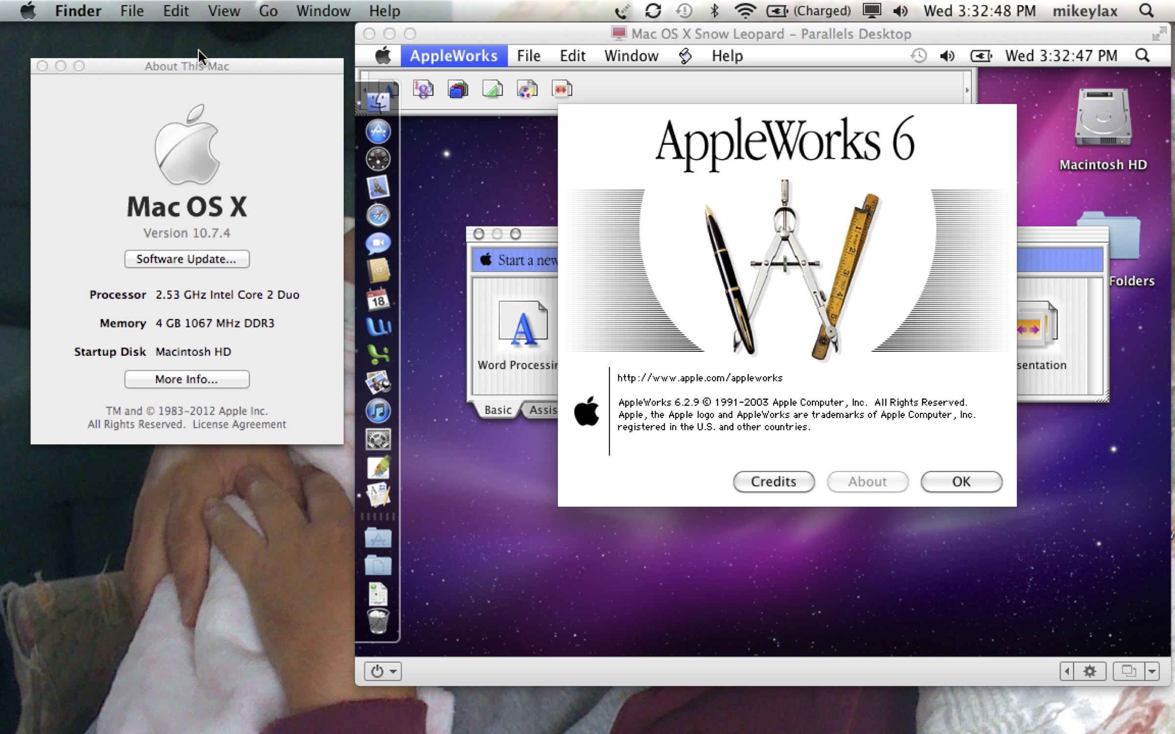

And then there's that other option. Run lion or mountain lion, but run your legacy software under snow leopard through VMWARE. Problem solved.

Full Snow Leopard Installation Instructions into Parallels 7

As the OP I would like to thank all of you good folks who have offered your expertise and opinions toward a solution to my little problem. The final solution for me was to follow Steve's approach. I already had a 10.6.3 disc supplied by Apple when I purchased the refurb MacPro, so I cloned the MacBook(10.5.8) to an external HDD and upgraded that using the 10.6.3 disc. I then ran the 10.6.8 combo upgrade and booted the MP from that drive. Seems to be working well, no issues so far, although I have been spending a lot of time setting up Lion and working with it as much as possible. I'm attempting to get things set to use as many of my most important apps as possible in Lion, but I know there will still be a few that I might have to run in SL. Of course that would mean rebooting into SL, which is a bit of a nuisance. If I could run it in Parallels that would seem to be a much more convenient solution. I must admit that I have absolutely NO experience with Parallels and I've been reading the suggested method for installing SL into the Parallels environment.
All of this to set up the likely ridiculous question I am about to ask. Once in the Parallels environment, would it be possible to clone the external drive with SL installed and would it run as expected, or at all? My guess is that neither of those options would work. It would seem to be a far too simple approach, considering the one suggested by MichaelLAX for installing SL in Parallels. However, please consider my total lack of experience with Parallels and forgive my ignorance in this matter. I abide by the saying that the only stupid questions are the ones not asked.

I suspect that Parallels will not afford you a way to install a clone of an external disk that then becomes bootable in Parallels (and not just accessible as an additional virtual hard disk).
Which raises the question: why not just install Snow Leopard into Parallels and then install the PowerPC applications into it that you need to run in SL? It should not take up that much time and only has to be done once. Once completed, I always recommend that a duplicate copy of the Snow Leopard.pvm file be kept in case the original one becomes corrupt.
Further I always advise that you should NEVER save data files in a virtualized environment (including Windows). I always keep these file in my Lion environment and then access and modify them in Snow Leopard, but again save them back in the Lion environment.
