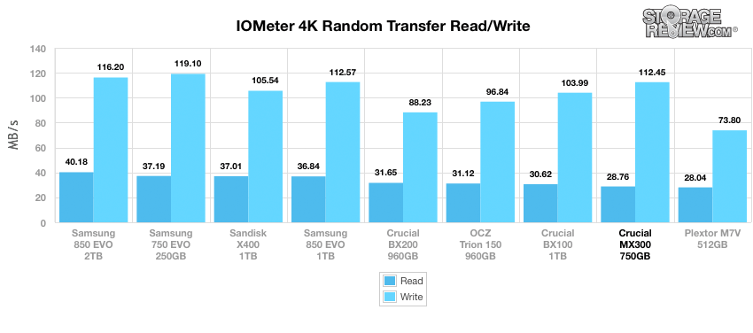

The number is actually 6 Gbps not 6 GB/s, and it's the max theoretical speed of the interface, not the actual speed of the drive.
Really, the only thing you should be concerned about is the random read speed, and the Samsung 850 EVO is faster.
http://www.storagereview.com/crucial_mx300_ssd_review
However, anything above about 20 MB/s for 4K random writes will make your machine feel very, very fast.

You mention SSHD instead of SSD, what's the deal with that, and is the 850 or 860 Samsung EVO good enough?
Not sure what the difference is between the 850 Evo or 860 Sata lll Evo is? or the RAM as I'd asked on #43 up here.
Thanks, I do use online banking, and desperate for latest iTunes as old one locked out all devices.
Time Machine on Snow Leopard will still put stuff back files as is, even on a different operating system presumably or do I need to book back up on SL after new SSD and then upgrade to later OS?
The RAM you linked to should work just fine. The 860 has a higher amount of total lifespan writes as opposed to the 850, but the same read/write speed.
