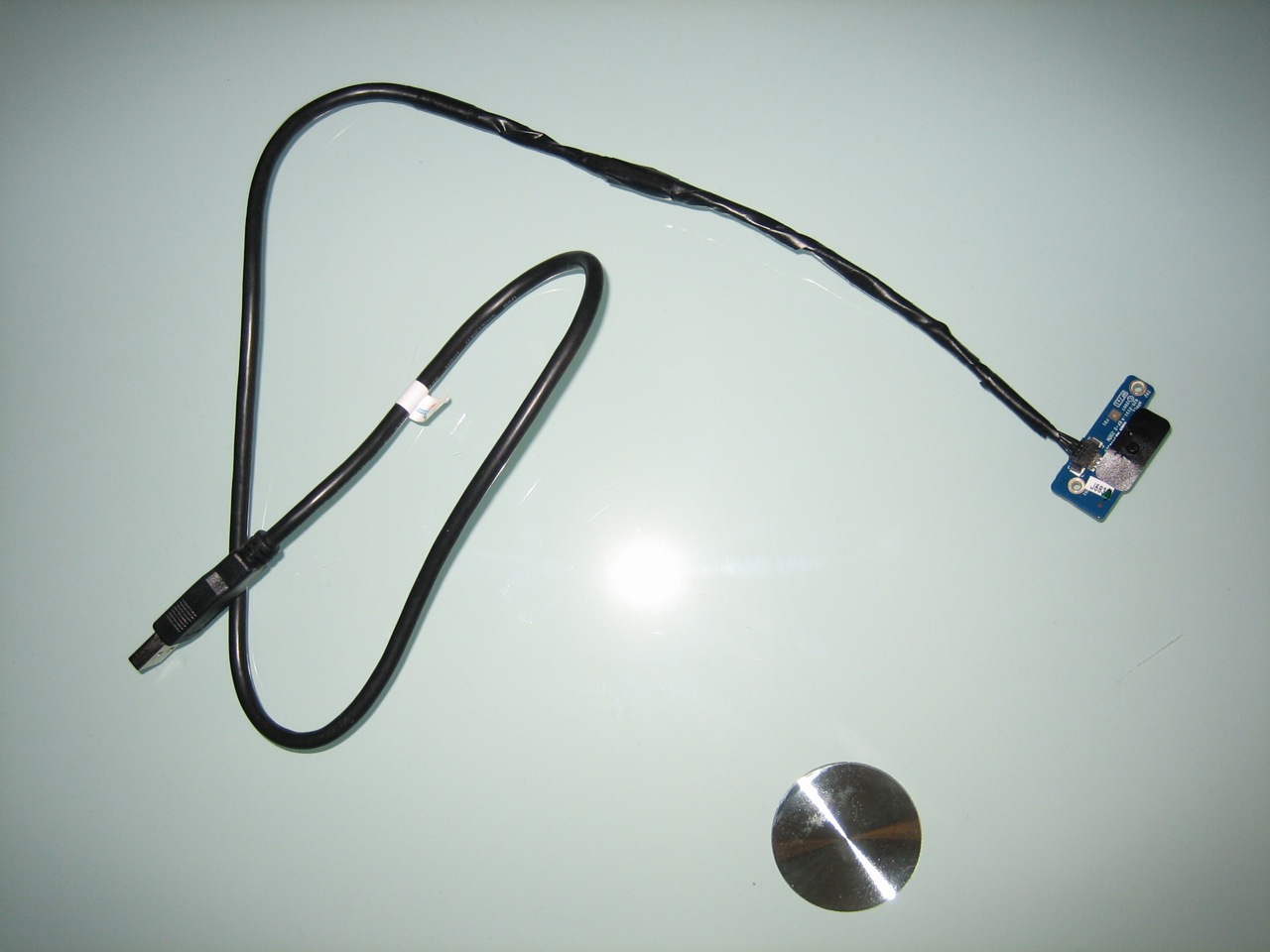

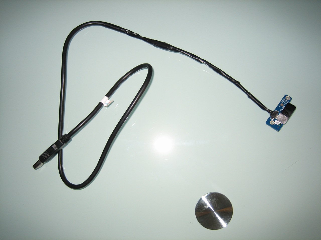

I just put together something very similar after getting annoyed with my Manta TR1 and both the Remote Buddy and Mira (which both work with the Manta TR1 sensor).
I purchased an iMac 24" infra red sensor and an iMac 20" Thermal Sensor Cable (as it has the right type of plug to fit into the sensor). Then cut one end off the sensor cable and one end off an old usb cable and soldered the wires together. Works perfectly with the Apple remote with no additional software.
All I need to do now is buy a PCIe USB card with an internal port, so that I can easily stick it inside my Mac Pro. Not quite sure where yet though, maybe route it up into the optical bay area

The machined holes on the front of the mac pro look a very nice fit for the black rounded end of the IR receiver 🙂
Yeah it's pretty much an exact fit, well it's just snug enough to hold in place.
Though it would need to either be routed up into the optical bay area, which I've done before with sata cables. Or maybe between or beside hard drive bay 1 and the fan cowling so I could get it to the front.
Just taking a look and it might fit nicely between hard drive 1 and the front of the system. Should be easier to position, as you can just remove the drive to get at it.

Alfihar: Im thinking above the first superdrive would be a nice place for it - up high.

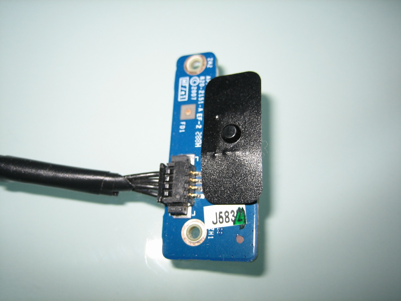

Which one? There are many temp sensor cables and different part numbers even for just the iMac 20".
There are various cables with plugs that should fit, the one I went for had a part number of 593-0192-A.
For completeness the sensor board was an 820-2151-A.
I wanted to go for the easy option of just soldering the wires together, though you could buy just the sensor and solder some wires directly to it if you wanted.

Thanks for the info Alfihar - so I can hook up one of these IR sensors and wire it to the USB port on my Mac Pro (which has no IR sensor) and use the Apple remote without having to use remote buddy or Mira or ANY other software??
Will this also work when I use PLEX or XBMC? (standard Apple remote is an option for control in the Plex / XBMC settings)

Yes, it will work perfectly. Exactly how it does on any macine with the IR sensor built in. 🙂
