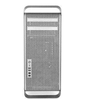

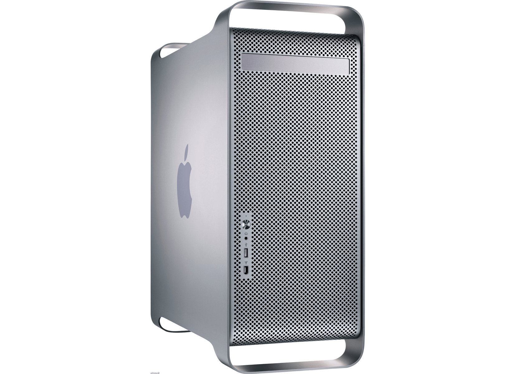

To my knowledge, the Mac Pro never shipped with a 2.5GHz processor.
Look at the front of your tower and tell us how many CD/DVD drive panels you see. If there is only one panel, then you have a Power Mac G5. If there are two panels, you have a Mac Pro.
(See attached photos for reference.)
Also, can you clarify what your exact problem is? It sounds like you're saying that the system starts up fine and you reach the login screen as expected, but you are unable to move the mouse pointer or type on the keyboard. Is that correct?

Thanks Soba - yes there are 2 CD panels so Mac pro. I thought it wasn't powerpc.
Yes youre correct - loads fine to login page but cursor is frozen. Can't seem to get wired mouse / keyboard to connect worringly.
