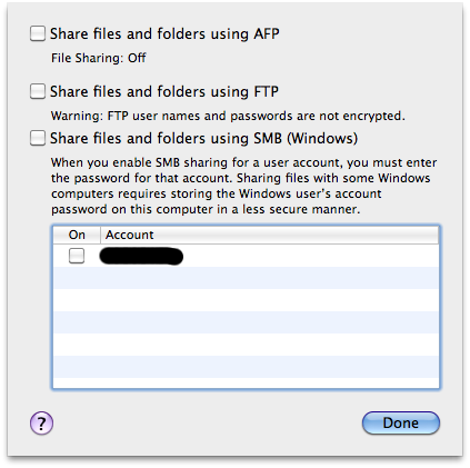

Huh. Are you not using Snow Leopard then? I am, and it requires some additional setup work be done in the Sharing pane of System Preferences - namely, at least one account needs to be turned on. Attached is a picture showing what I mean - you click Options after clicking File Sharing in the Sharing pane to bring up that dialog.

I'm able to FTP using 1 of the 2 user accounts in that sharing window. I can't figure out why the 2nd one won't allow. My primary account(admin) has no problems but the "sharing only" account i created can't log in.
