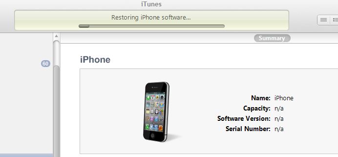

I'm trying to do a full restore on my iPhone 4 from recovery mode. It is currently hanging on the progress bar at about 10% on iTunes and the iPhone. Been like this for over an hour. iTunes is still responsive.
Trying to upgrade from 4.0.1 to 5.0. Wanted a fresh phone so did it via a restore as apposed to an update.
Hope someone can help!

None of that seemed to work. :/ Getting a tad frustrated with it now. Seems totally stuck! I'd rather get it back to my old firmware than sitting like this! 🙁
unplug it from Itunes, do a hard reset and see if it bring back your phone. Press & how power button and home button at the same time for 10 - 15 seconds, then release both and power it on normally.
