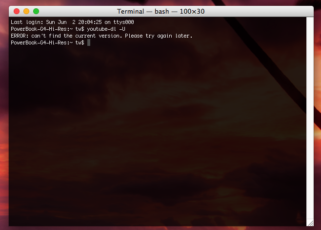

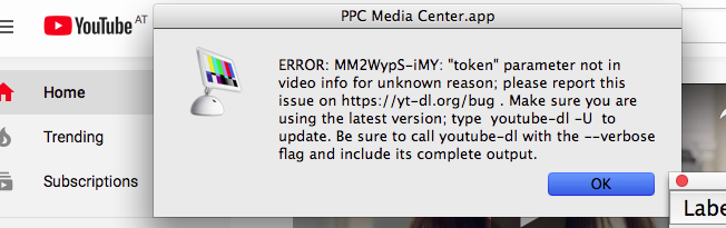

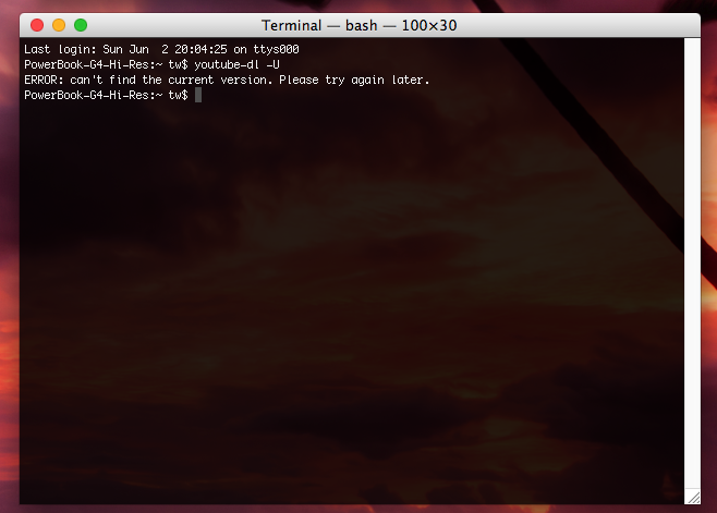

Does anybody know how to fix the now broken PPC Media Center application? Youtube-DL is no longer working and there is no updated version out there ... For the time being I'm using ArcticFox and the mobile site of Youtube in order to download the video files from googlevideo and to play it with VLC.
A few days ago it worked just fine for me - did YouTube change something again?
[doublepost=1559595027][/doublepost]Just try to download a new version from http://ytdl-org.github.io/youtube-dl/download.html and put it in /usr/local/bin/ where the old version should reside
Reactions: netsrot39
This is what I'm getting right now (see pics)
I'll try replacing / updating ytdl manually tomorrow and report back if it works.
Thanks for your help!
EDIT: After downloading the updated youtube-dl file and copying it over to /usr/local/bin/ PPC Media Center works normally again. Thanks again for the solution! 🙂

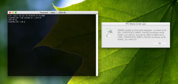

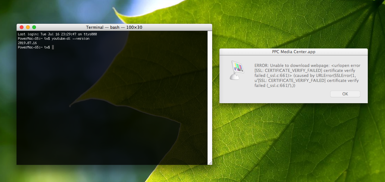

So it's me again, I'm encountering a new problem that has to do with some sort of an SSL error. I don't know if it is due to the fact that I installed Python 3 and updated my Python 2 version yesterday (via the official installer from their website) but I have python also installed via MacPorts (because I tried to run pyload). Checking the version of youtube-dl in Terminal reveals that I'm up to date. Does anybody know what I have to do in order to fix the issue? Are you experiencing issues with PPC Media Center? I'm uncertain whether I've messed up my system or YouTube changed something. Thanks!
I think once you start messing with Python you can end up with 2 versions of youtube-dl.
When I experimented with mps-youtube I had to update youtube-dl with pip:
sudo pip3 install youtube-dl --upgrade
