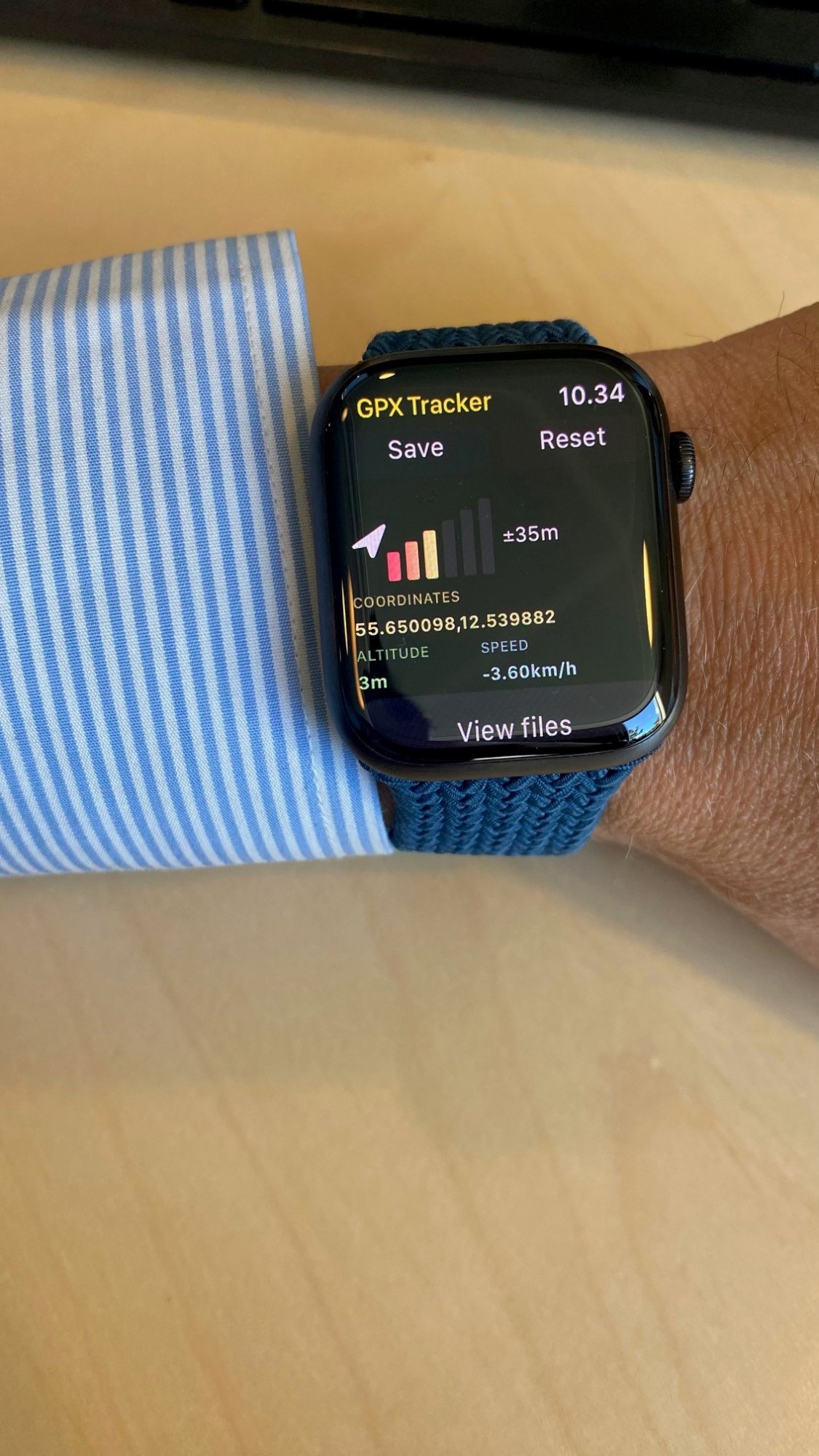

I have recently downloaded a GPX Tracker for a weekend hike I'm going on, to be able to see a GPX map file on my iPhone. I can see it also installed on my Apple Watch and actually has a pretty nifty GPS Signal meter. Might be a great app to open while warming up a couple of minutes before a run (Should be better to warm up anyway!!)
FYI, WorkOutDoors will let you upload a GPX map for hiking. It can also download the full map data for that route for offline use.
