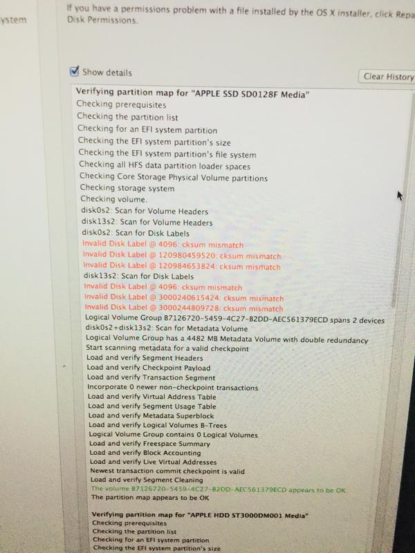

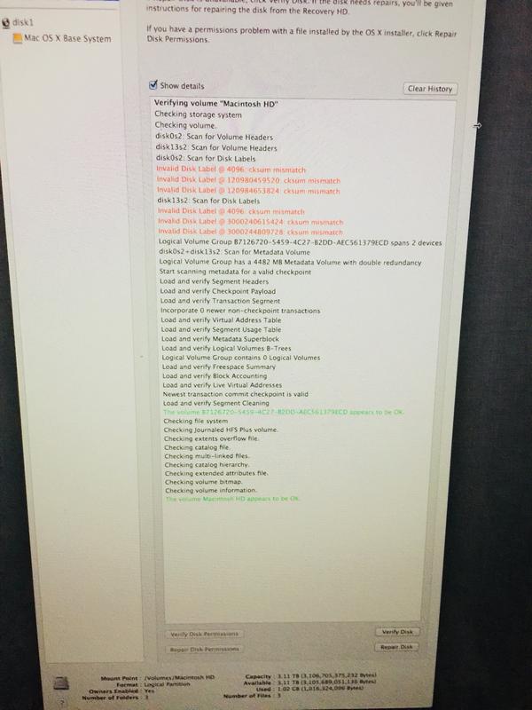

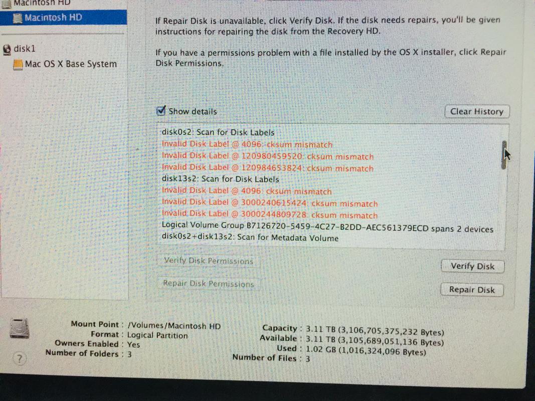

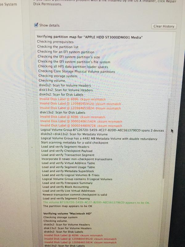

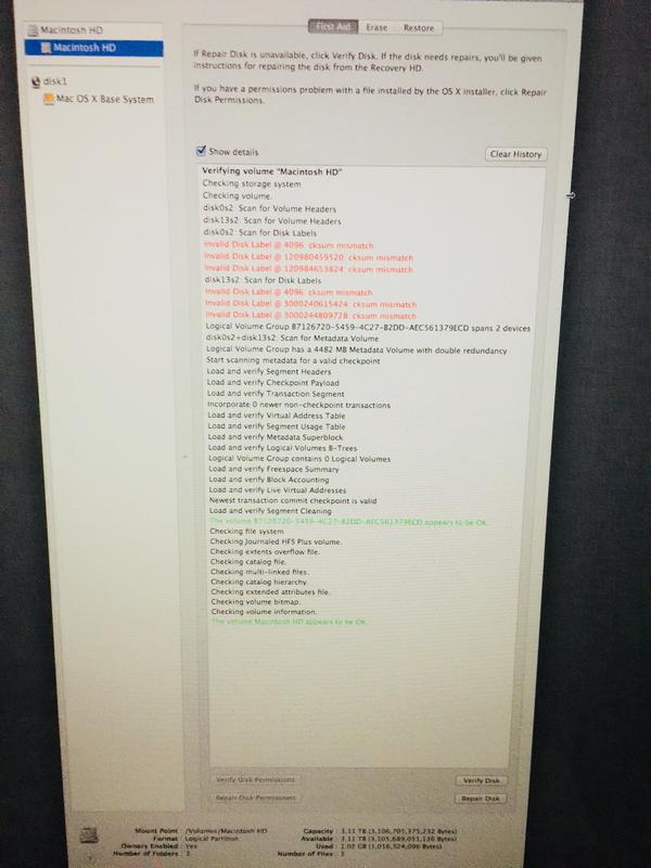

These are the results that I get back, even after hitting verify and repair disk. It keeps showing that invalid disk label error. So at this point, can anyone tell me what's wrong? Is my SSD bad or my HDD or both? I'm confused.
Look at the images posted above.
See "Macintosh HD" -- HIGHLIGHTED IN BLUE ??
You want to click on the "Macintosh HD" --ABOVE THIS--.
See what it says.
Looking at the images you posted, it looks like the SSD is reporting OK in Disk Utility.
