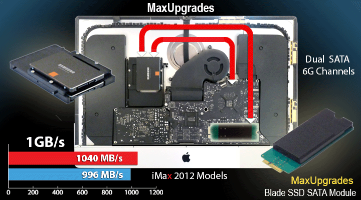

Number one is not possible. The iMac has a custom blade ssd.
It can.
http://www.maxupgrades.com/istore/i...e-with-heatsink-and-power-and-data-cables.cfm
