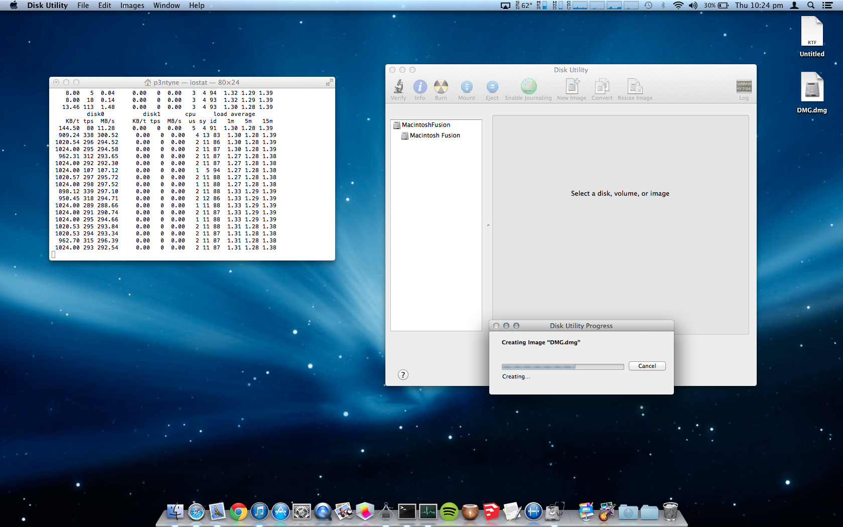

Yes. To test the write speed manually, open terminal and type 'iostat -c 2000'. This will give you a list of the disk activity. Next, create a .dmg of less than 4 Gb and watch the actual read speed of you drive.
In the screenshot you can see actual write speeds of which I get ~280-360. It is probably on the low side since the ssd portion is pretty full.
EDIT: Just did the test again after closing all other apps and got 354.
