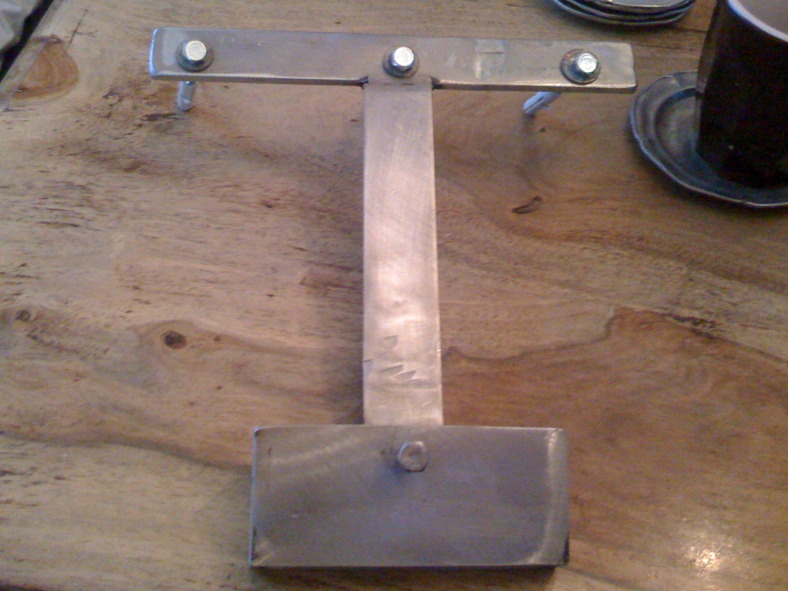

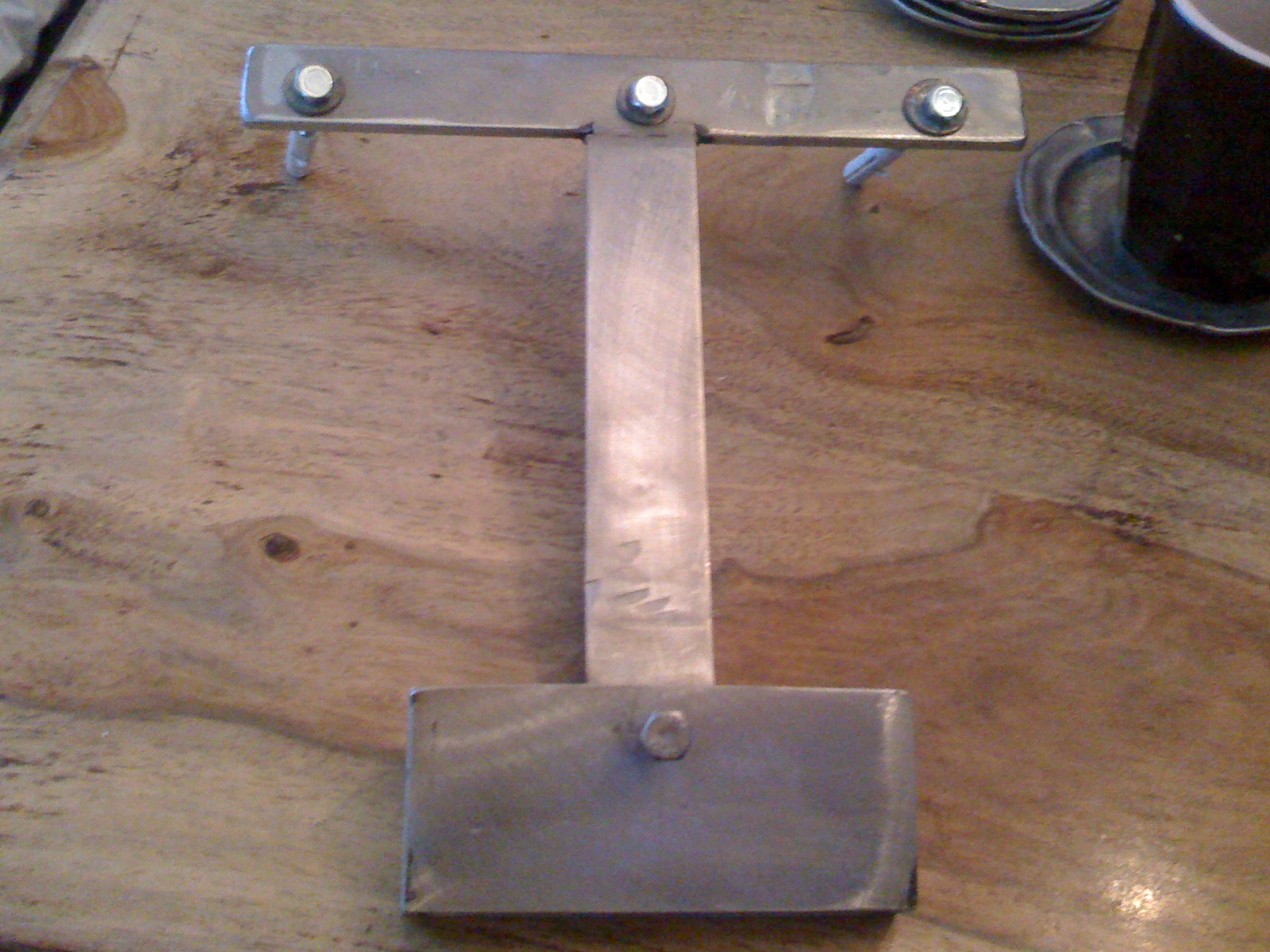

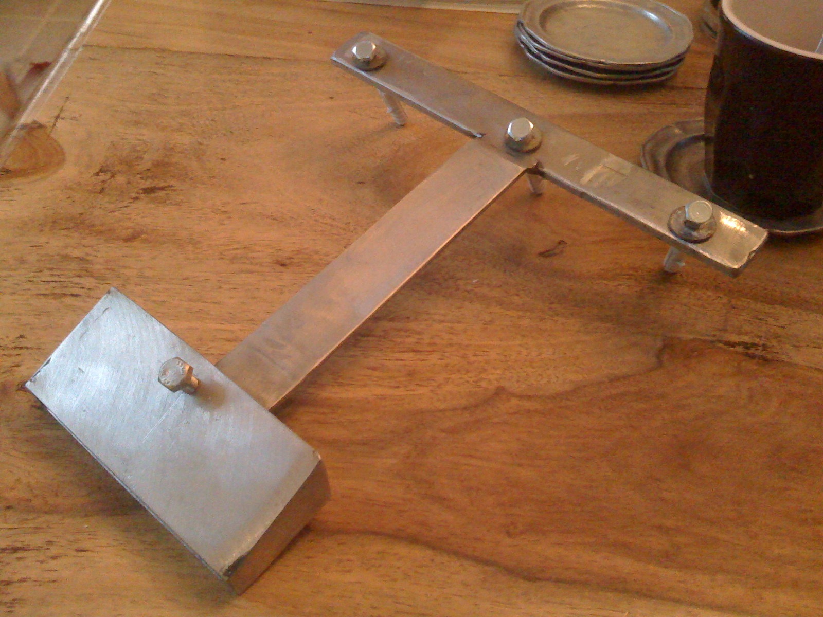

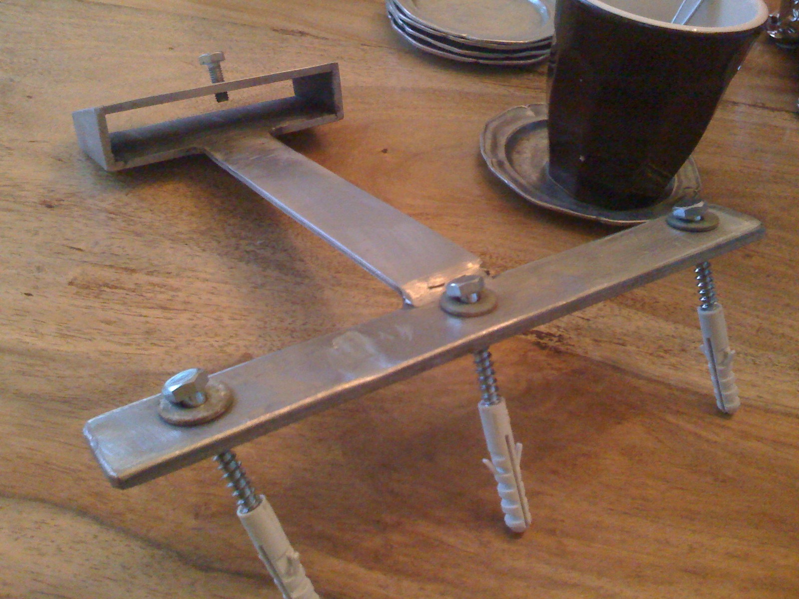

Wallmount 20" iMac Duo Core Aluminium model
Yes, you can wallmount iMac from now onwards, but it takes some creativity and guts.
First I tried to open my iMac via the front window to find out if it was possible to rebuild the aluminium stand. Unfortunately, this does not look a good idea to me afterall. Yes, I got to open it via the front 'glas' screen, de-mounted the aluminium frontframe and LCDscreen, but then I noticed a lot of miro-electronics and mini-cables which wasn't worth the effort to de-mount the whole computer before getting to the stand-connector. The risk destroying my iMac was too big.
My second option was to cut of the stand with saw (!!! yes with a saw) and create a frame to attach to the wall. I have attached some foto's to this reply. (My idea was posted here at december 26, 15.23 hrs). Please email me if you want to use the same idea (rob.verhoeven@vwlan.nl).
My iMac now hangs in the kitchen on my selfmade wallmount. I will send some pictures later on.
You can use the PDF to create this model yourself. It takes some guts, but in the end it is a very good solution.
In case you don't want to saw of the remaining part of your stand or you want to dis-mount it from the wall in the future, you always have the opportunity to fix the part which was cut of.
Please contact me per mail in case you have more questions regarding this wallmount.
Good luck,
Rob Verhoeven
