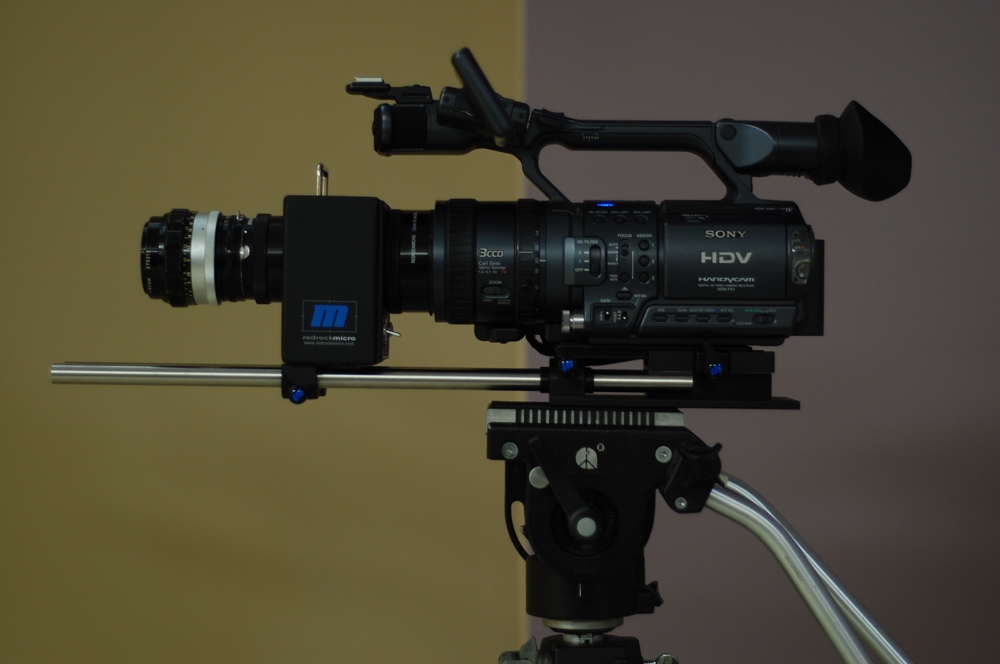

I'm curious to see what the camera looks like with the lens and adapter on it. Can you take a pic?

Sure... I'll take a pic as soon as I get back to the office.

For zioxide, a photo of the rig while using an 85mm lens is attached.
