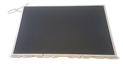

  • Can the 12.1” 1400×1050 screen PowerBooks can be upgraded with be installed in iBooks?
  • Can the 14.1” 1400×1050 screen available from the ThinkPad T21 to the T61 be installed in iBooks?
My experience:
I did get a panel that was listed in the "upgrade the 12" PB display" threads about 2 or 3 years ago.
It installed fin in the 1.33GHz 12" iBook but on powering on the cable got super hot.
The iBook ist still working with it's original screen.
So:
- Did I get the wrong panel?
- Did I get a broken panel?
- Is the pinout different between iBooks and PowerBooks?
Reactions: lepidotós
Within the same screen vendor, the pinouts are the same.
For most of the 12-inch PowerBooks, if not all of them, displays were supplied by LG. For iBook G4s, I believe the pinouts were also all LG displays, but for iBook G3s — especially so the clamshell units — the displays were supplied by LG, Samsung, and IBM; each of these vendors used different pinouts (and Apple cables) to connect to the logic board.
As for the BOE-Hydis 1400x1050p displays sourced from a particular ThinkPad series, I am fairly certain, based on step-by-step upgrades posted online, that the LVDS cable used for it are the same pinouts as on the LG displays.
Do the 1440x960 screens work on the 1GHz TiBooks? I'm wondering if it might be a bit much for the Radeon 9000, but the fact it can push both 1280x854 and 2048x1536 simultaneously seems to suggest it should be fine. Now it's a question of if the cables are pin compatible.​
Reactions: Amethyst1
The 1440x960p displays are a 1.5:1 ratio, whereas the 1152x864 displays of the Titanium series are 1.33:1. Although the GPU might be able to drive it, the LCD wouldn’t fit, as-is, inside a Titanium bezel.
The Titanium uses 1152×768 or 1280×854 LCDs, the former being perfect 3:2. 🙂
Fair point, although their dimensions are different — with the Titanium models a 15.2-inch display, and the Aluminium models with a 15.0-inch display. Consequently, the Titanium models have slightly wider bezels, physically so, to accommodate. Unless I’m missing something crucial here?
Panelook only lists 15.2-inch panels with a resolution of 1280×854 or 1440×960. And Mactracker confirms all mid-size AlBooks to have 15.2-inch panels.
I had to break out my dead, 400MHz Ti and a ruler to measure it, diagonally, followed by the same for the 1.67GHz 15-inch running SL-PPC. Indeed, the diagonal measurement is 38.75cm on the Ti and 38.7cm on the Al. I guess there’s an optical illusion to the design of the Ti case, as in having them side-by-side, the Ti still appears wider. Huh. Interesting. My bad!
The AlBook case has the thin darker plastic ring around the frame that may give the illusion the bezels are thinner.
