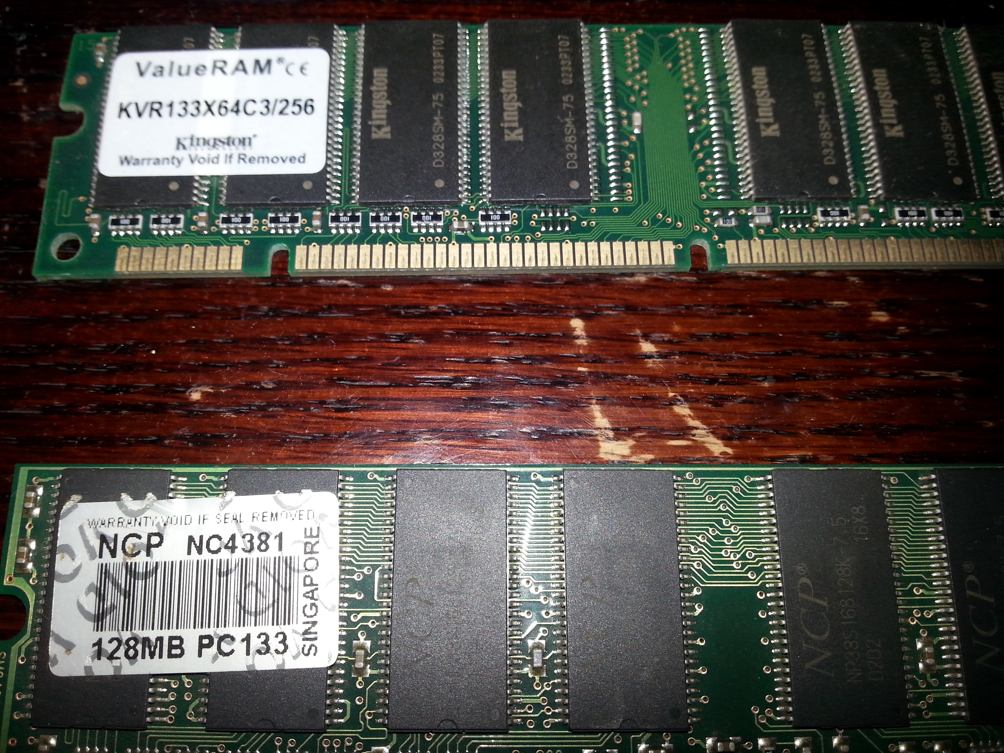

Sorry for my ignorance on the next question, but a PC DIMM should work in the G3?
My G3 has 4 DIMM 128MB 133MHZ and I have found a 256MB 133MHZ from a PC and I was wondering if I can used this DIMM or should I buy special DIMM for the G3?
Here I have attach a picture.
Up is the PC DIMM and bellow the former and faulty G3 DIMM

There is no difference between memory types for Macs and non-Macs. Memory is memory. As long as the other stick is low density and fits in the slot, it will very likely work. The worst that will happen is your machine will beep/blink out an error code for faulty memory.
Not so sure about your first statement although in theory it should be correct. I bought a couple of sticks of PC133 recently and happened upon this local seller on Amazon UK. I am familiar with the brand but the ad clearly stated that the sticks were not compatible with Apple computers. The same seller had other PC133 ram that was Mac compatible and obviously cost a little more.
Might be just a scam to upsell to the unwary but all the non-ECC PC133 desktop ram I have ever seen looked identical. The low/high density split seemed to be more of an issue for sodimms.
It's all an up sale. Just like buying a Mac external hard drive or internal hard drive. No different other than it come pre-formatted in HFS+.
I thought as much, although some of the low ranking reviews would indicate a problem with chip density with only half the ram recognised on both PCs and Macs and some computers not registering the ram at all.
I know that my Wallstreet will deal with high density ram but only recognise half the registered total whereas the same sticks in my Pismos work without issue - but then again, they are laptops and those tend to be picky about ram.
