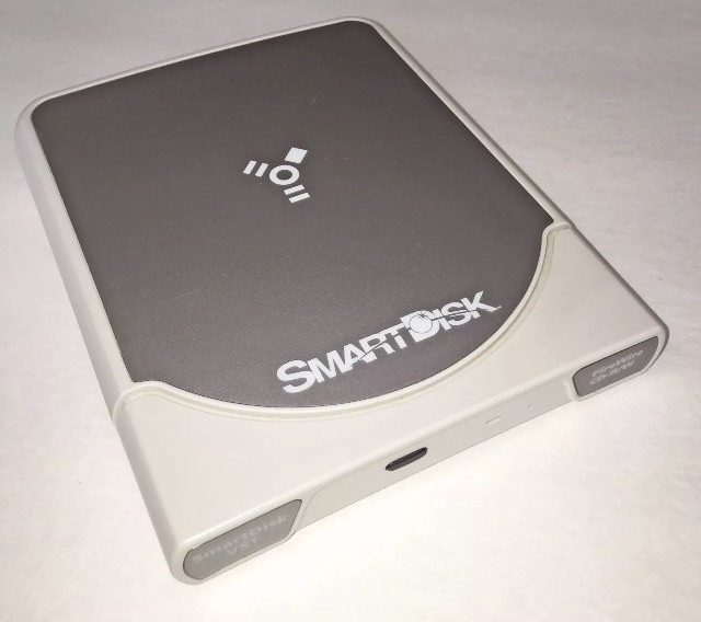

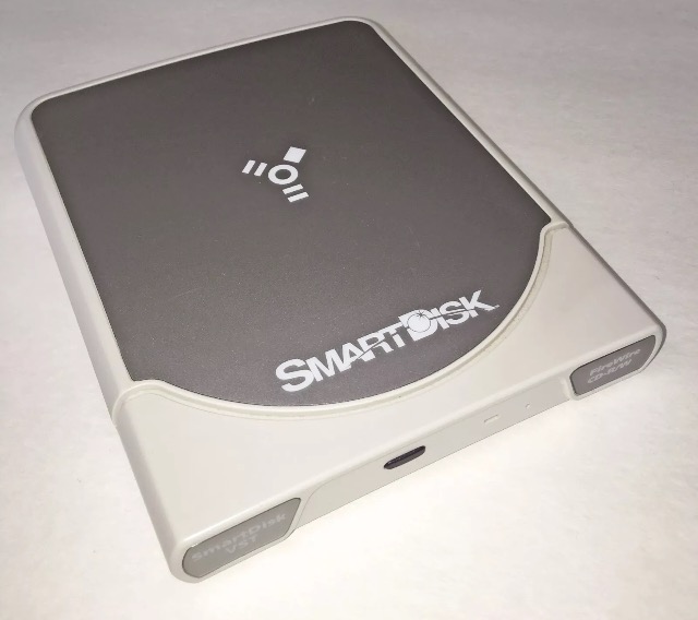

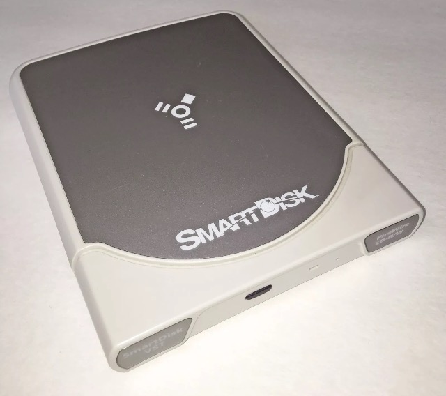

Back in the day, I used FW optical drives when built in drives would not behave. I still have a couple of these bus powered Smartdisk drives that come in handy now and then.
LOL That Smartdisk firewire CDRW was an extra that Apple sent to me along with my Titanium Powerbook 400ghz which only had a CDROM.
But OP needs a DVD player. He should just get an external and boot from a Tiger disc or swap out the tray opening optical disc drive in the 900mhz. Bump it up to 640mb of ram, too.
