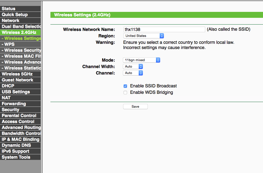

thanks for the reply. I think the Linksys network was one of those encryptions. I just don't know which settings on the new router you are saying to check. Here is a pic of my 2.4 band settings.
I can add other snapshots of a setting if you see it. thanks.

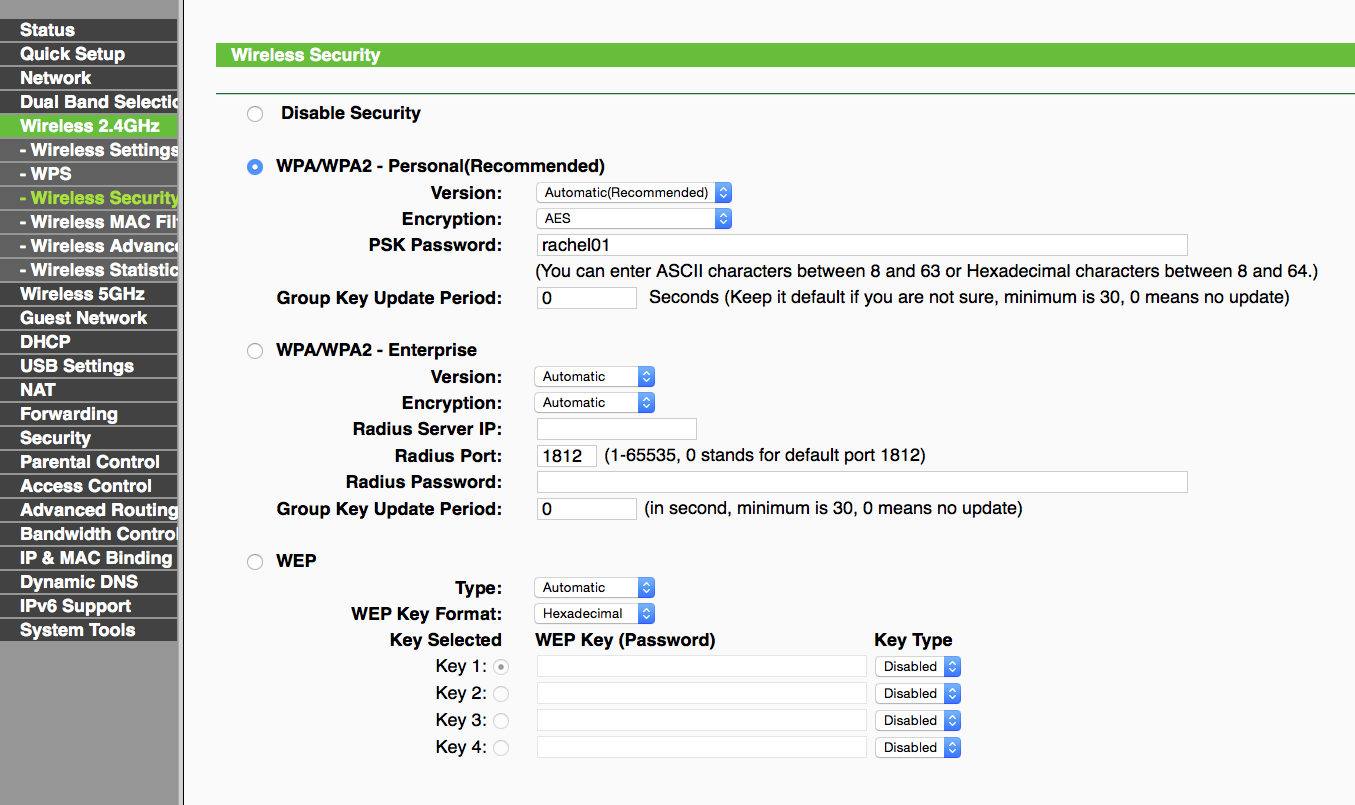

When I change the encryption this is what I get:
I use the 5 band for my wireless usage with the iPad. The G3 would be the only device in my house that would be on the 2.4. Every other device in my house is wired. So if I can't set up the G3 to get wireless, no biggie. It would be nice to know I could if I wanted. thanks again.
The last screenshot is TKIP, which is what you want. Can you connect?
If not, what does it give you as options in the "Version" popup (the one before the 'Encryption' popup)?
Well I set encryption to automatic and rebooted the router but it wouldn't connect. didn't know if I should set it to TKIP and reboot in case that might mess things up. under version is:
WPA-PSK
WPA2-PSK
Under version then, use WPA-PSK.
You can't use WPA2-PSK, your iBook won't connect to it. And I'm willing to bet that "Automatic(Recommended)' is defaulting to WPA2-PSK.
