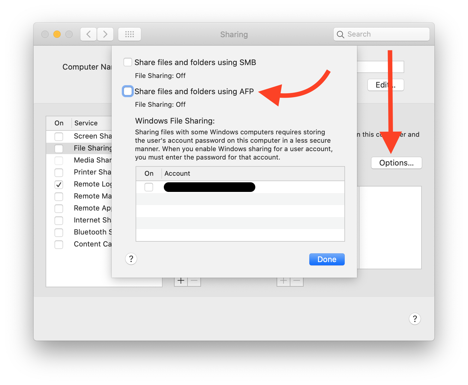

Unfortunately, you can't make the G4 see files on the Mini unless you downgrade to Mojave.
I'm not quite sure that's true.
All OSX version up to Mojave has support for SMB1 which allows your older macs to see files served by a SMB1 server. Starting with Catalina and onwards, the default file server protocol had been changed to SMB3 for better security, which means your G4 can't see files on the Mini. You need to downgrade to Mojave or older to allow your G4 to see the Mini. [...]
Yes, which is why I'm suggesting OP use AppleTalk and Apple Filesharing Protocol (AFP), not Super Mario Bros. (SMB).

Ok I feel incredibly stupid now... All I had to do was enable AFP on the Mini as you show above, and it's all working! Thanks a lot @David Hassholehoff .
The G4 still can't see the networked drive as a Time Machine destination, but I imagine that's a limitation of TM under Leopard.
EDIT: OK so it turns out that while I can now see the shared folders, I can't actually see any of their contents - they are empty when I click on them, and under 'info' they show as Zero KB folders. Is there something else I'm missing?
