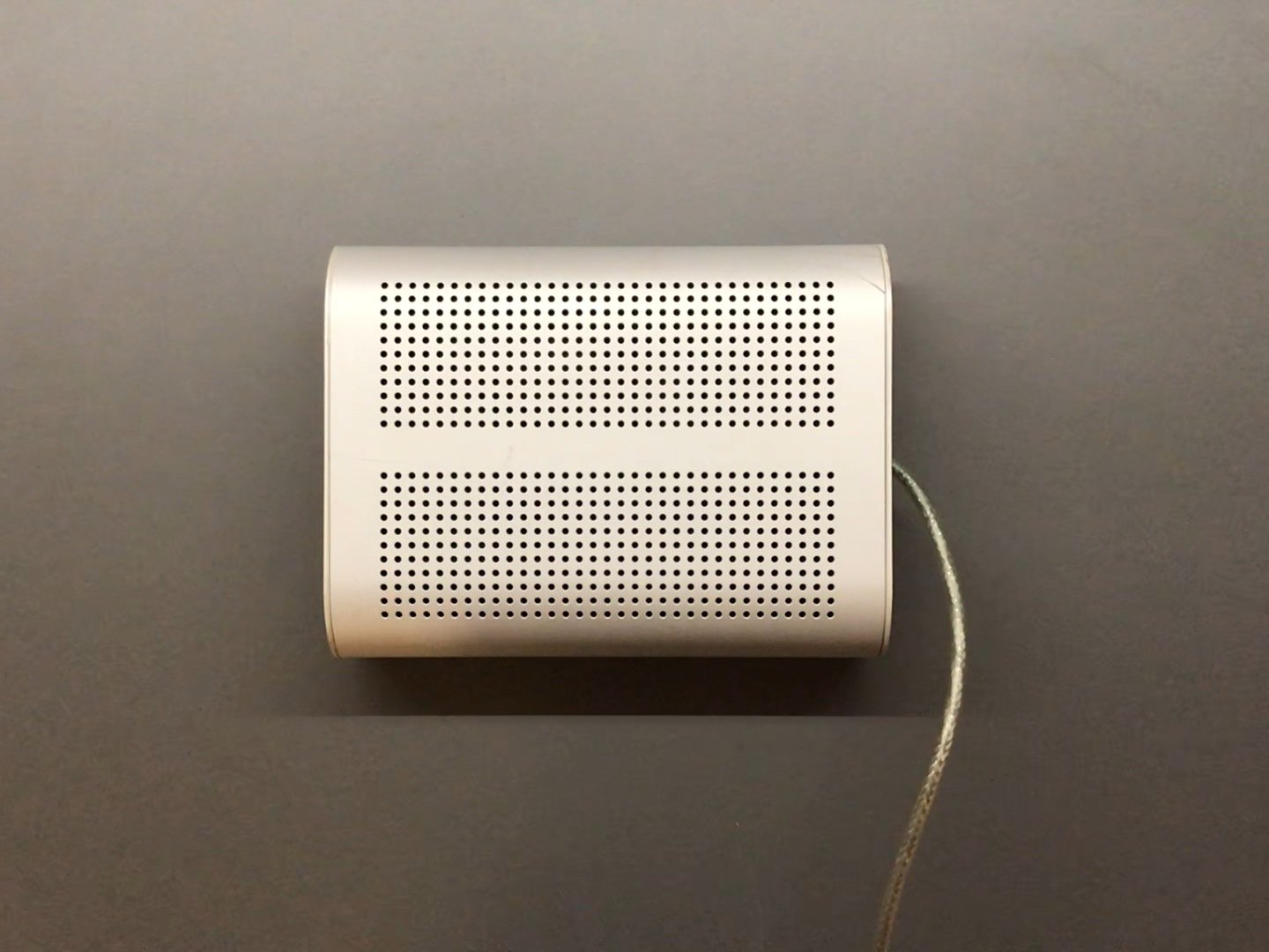

The 4 pins from the powercord are very close to each other and close to the shielding as well. I am afraid of creating a shortcut. I understand that replacement powersupplies are quite expensive

as long as you can get some fine enough probes, it should be ok. You could also insulate the pins you are not testing from the ones you are with some electrical tape or something.

The fluctuation of the powerlight might also be an indication that there is something wrong with the powersupply after it gets warm/hot. I will take it apart and see if the capacitors in it are not leaking. It might even be easier from inside to test the voltage stability.

You would think that almost any part of the PS should be re-buildable with new components, unless it is multilayer PCB or something. Best of luck!
The two clips one the side were OK. But the middle I could not get to so I used my Dremel and cut it open. The inside also looks as if everything is solid state. Doesnot look like it can be reapaired. All glued and covered with white putty :-(

I guess the "glue-it-all-to-hell" era started earlier than I realized 😳
Rocksteady 28 Volt, so the PS looks OK. I will now look into replacement of the proximity power switch board
