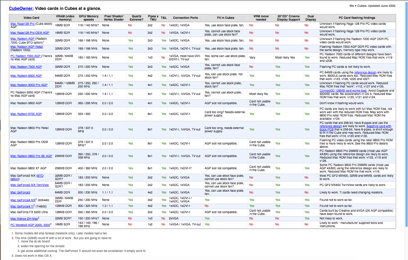

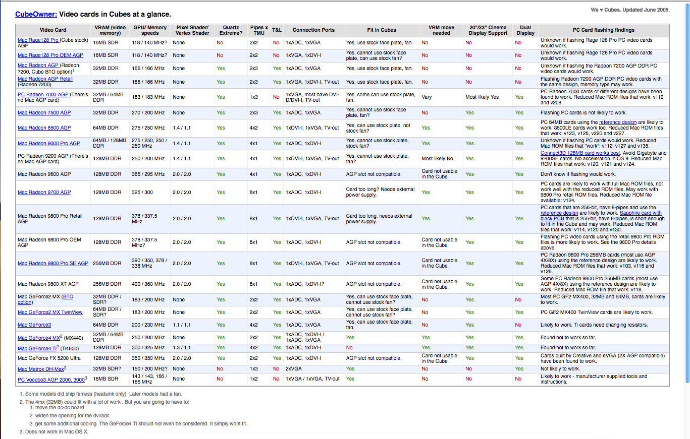

As for graphic cards for the Cube, did this image come up in a recent discussion?
The Cube is also USB 1.1, and can’t be upgraded to USB 2 (as far as I’m aware!). So external h264 video decoders would be affected by that.
I have previously seen that chart. Once you crunch through it, there aren’t too many practical options. Any 6800 is way too power intensive / big to be in the running. I presume the 6600 is too? There may be one very rare 9700 or 9800 that physically fits, but the VRM would likely catch fire!
