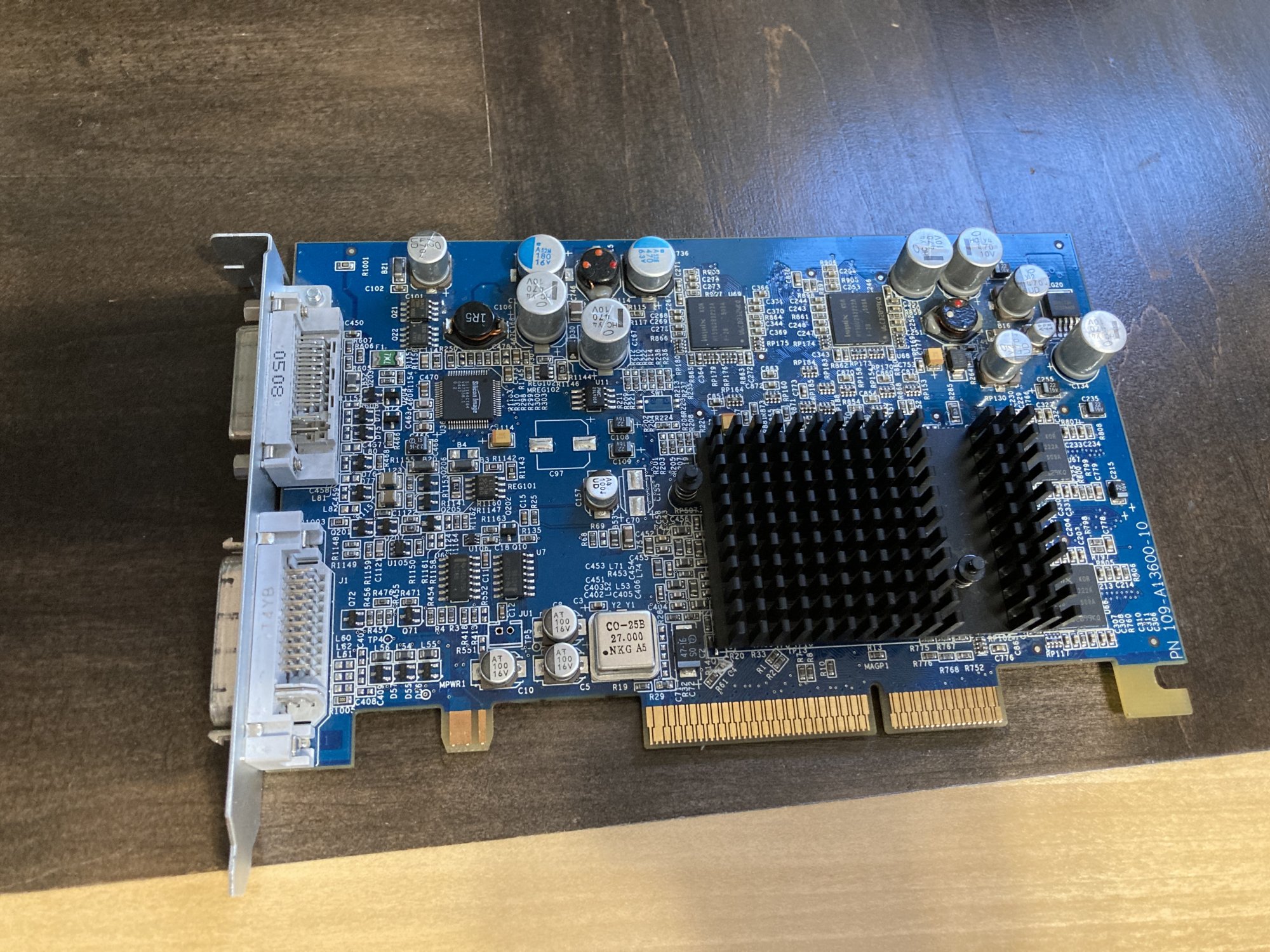

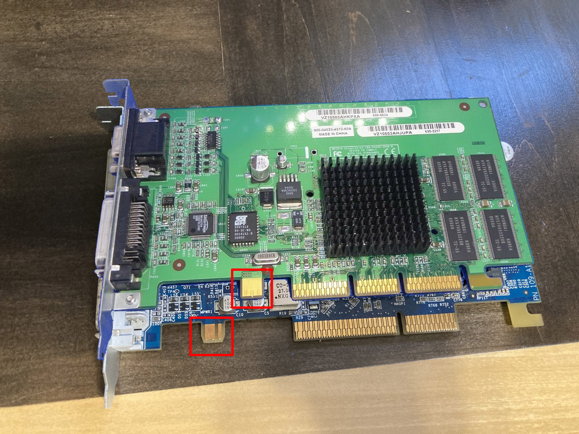

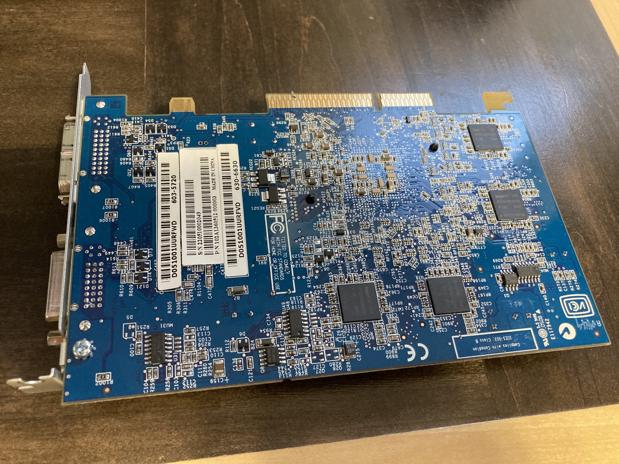

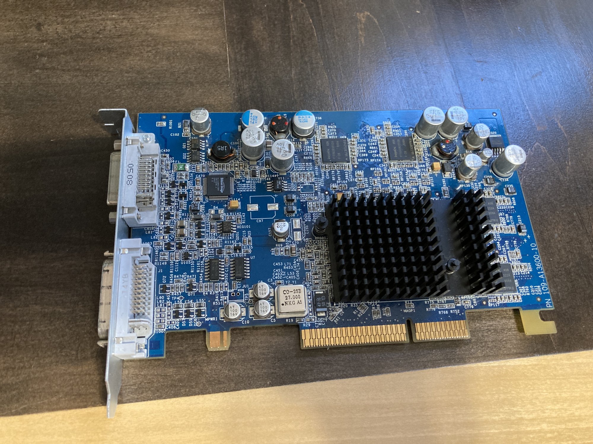

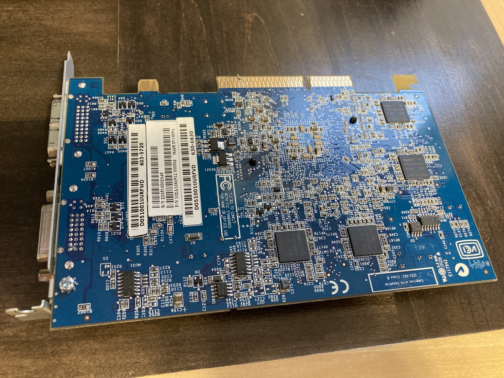

I've got a G4 Digital Audio and just bought a Radeon 9600 XT from a G5, and after taping pins 3 and 11 and installing the card, the computer will boot, but nothing shows up on the screen, and when I connect to it via VNC and look at system profiler, the graphics page is blank. Does anybody have any ideas?

Anyway, I should have mentioned before that I forgot to unplug the computer when I installed it initially, and when I plugged the card into the logic board, the machine started before the card was fully seated, so I don't know if I could have fried the card. I know the logic board is fine, because the original card still works. I played around with it a bit more last night, thinking maybe the tape on the pins was getting dislodged, so I tried booting without pin 3 or pin 11 taped. Without pin 3 taped, it wouldn't do anything, as expected, and without pin 11 taped, it would chime but wouldn't go any further than that. No power to the peripherals when it won't fully boot (coincidentally the SiI3112 SATA card I just tried to put in this week behaved the same way, though I think I found the fix for that). With pin 11 taped, it boots most of the time, but sometimes it hangs after the chime and requires a reboot to boot OS X, so that leads me to believe that the logic board just doesn't like the 9600, or that the card is dead.
