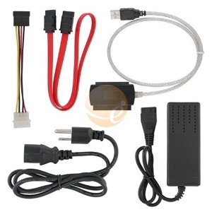

Pull out the hard drive carefully... pick up one of these little beauties for anywhere from $10-20...
The device above will allow you to connect your old removed hard drive to your new machine via USB... you can then just drag and drop your old files onto your new machine... easy peazy lemon squeezey my friend.
http://www.amazon.com/USB-2-0-SATA-Cable-Adapter/dp/B001OOXBBG

Otherwise, those USB to ATA/SATA adapters are awesome. I got it to do a hard drive transfer, and now I find myself using it for all sorts of drive-related things.
http://eshop.macsales.com/item/Newer Technology/U2NV2SPATA/
