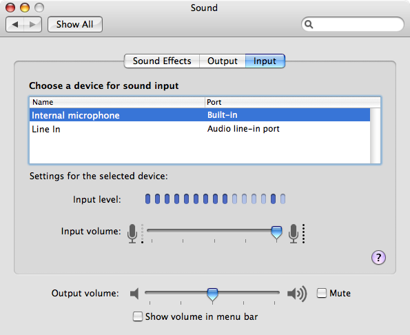

Is there no signal in both System Preferences and in Garageband? System Preferences should have a bar that responds to sound input (named Input Level), if the mic is working.

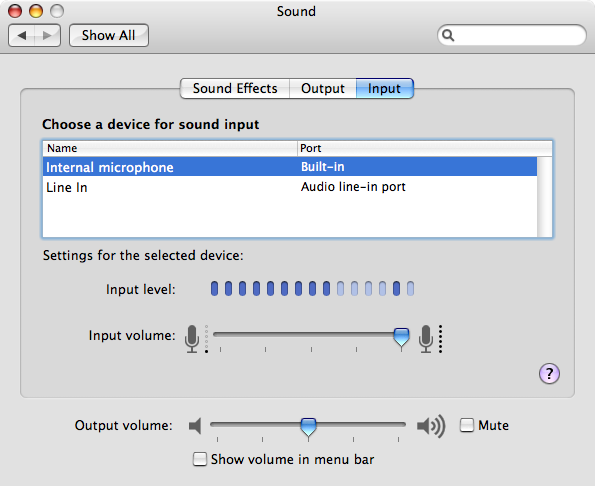

I took this picture on my iMac G5 and not my PowerBook G4, but the only way I can get the internal mic to work on my G4 is by turning on 'Speakable Items.' Does that get it working?
