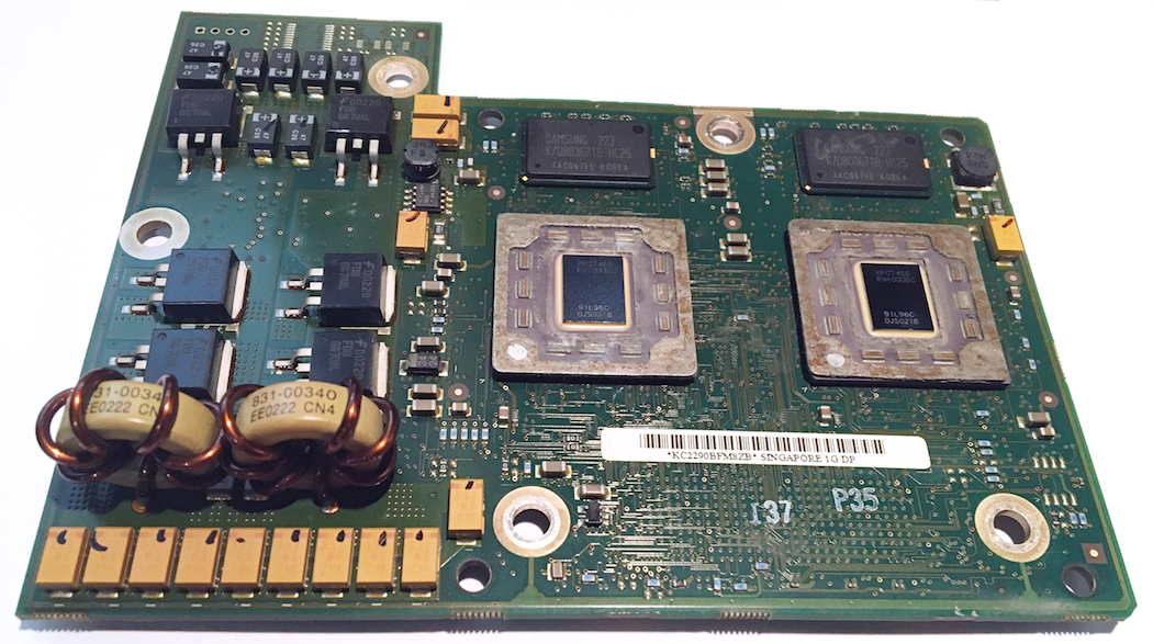

Thanks for the replies. I have given up on that daughterboard (the criminal brain). Decided that the L3 chips on it are toast. The Mac works beautifully with its original single processor board installed. Everything is clean and in good condition. I am the original owner of this early 2002 G4 Qs. New problem is I tried installing a different daughterboard that I got from a friend. It is supposed to be a dual 1 Ghz, from a similar Mac (see attached). Again, working beautifully before I put this board in (using ESD precautions), then on first boot it went into Open Firmware with this error:

The problem was, I had NO mouse function and NO keyboard function, so unable to enter any commands at all. Restarted using the power button on the front, and now I also have NO monitor. Screen is black. Pretty much dead in the water. Can someone decipher the error above, tell me what it means?
Since I do not know the whole history of this new DB, I wonder if someone might have messed around with the clock speed... maybe tried to set it above 1 Ghz? Also wonder if both the MB and the DB have to have similar version serial numbers, like both SNs ending in 'A' or ending in 'B'? Seems to be a basic compatibility issue of some kind to me.
I was expecting a 'plug and play' scenario. I mean, the 'criminal brain' booted right up no problem, and functioned pretty normally except for having no L3 cache. Thanks in advance.

That error looks like one of the CPUs crashed while booting. You could try disabling one in open firmware just to see if it boots. Is that picture the actual CPU? There is also a dual 800MHz version that looks similar, and is known for compatibility problems.

Thank you for your help! Afraid I can't disable anything because I have no keyboard, mouse, or monitor function. Any idea how to get those back? The image shows the actual DB that I installed, and my friend told me it was a dual 1 Ghz. Your comment about the dual 800 is interesting. However, it does not look exactly like the last dual 1 Ghz DB I tried (the one that had bad L3 chips). There was no chance of it overheating because it immediately went into that default catch error before it even got warm. All screws were nice and tight... I double checked. I have the correct heatsink for a dual processor.
That is a dual 1GHz then. Do you have a volt meter? The OEM duals use a lot of power, and maybe the power supply is not cutting it? Check the 12v line...

I purchased a 3rd dual 1 Ghz DB from DV Warehouse. When I removed the 'default catch' DB today and started to clean it, I noticed that the paste (MX-4) on one of the chips was fresh and soft... it basically just wiped off. The paste on the second CPU chip was baked on hard. So, that means that one chip was functioning, and the other was not. I think Ervus was right. One was crashing. Anyway, I installed the new dual 1 Ghz DB today and all systems are 'Go.' Went off without a hitch. It was basically just plug 'n' play. So, I had the bad luck of getting two bad daughterboards. Can someone recommend someone who can test and repair board #1, the Criminal Brain? I am assuming that it needs the L3 chips replaced. I don't want to pay an arm and a leg. Thnx!
