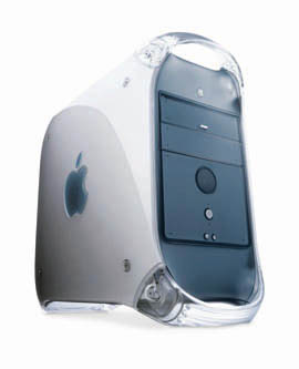

Okay, I tried to use target boot mode (on a second G4), but the computer shuts down. I read that one G4 model, the one with PCI graphics doesn't support TDM, but I don't know if mine is PCI or AGP. It has the blue front plate like in the picture I posted.
