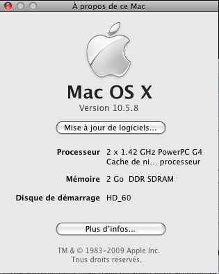

It works!!!
Finally got the other CPU and IT WORKS!!!
Now I have a fully functionnal dual boot 1.42 ghz G4 MDD.
Phase 1 completed....
