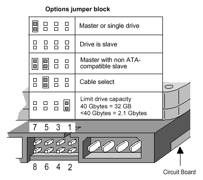

Attached is the jumper settings for a Seagate HD.

I see from the jumper settings that I should have one installed far left. So should I remove the one that came with it from the factory? It's in the cable select slot.
KP
Yes, make the jumpers you have match the "Master" configuration.
(I'm assuming that you don't have any other HDDs on that cable.)
My experience with the Digital Audio PowerMacs has been that they are VERY picky about jumper settings, they particularly hate Cable Select fro some reason.

I'll try putting the jumper where you advise first thing tonight when I get home. I wonder why Seagate puts a jumper in that slot straight from the factory when not every application requires it....

Ok, removed the jumper from the factory, installed one in the Master. Same thing.
Anything else I could try?
