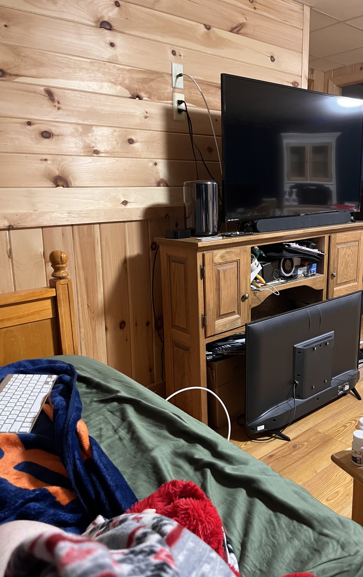

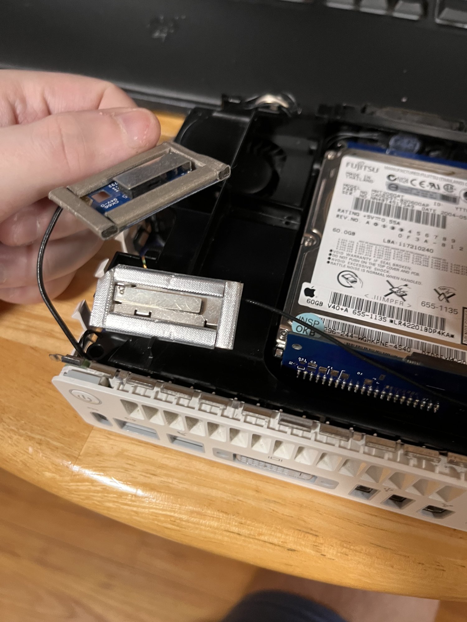

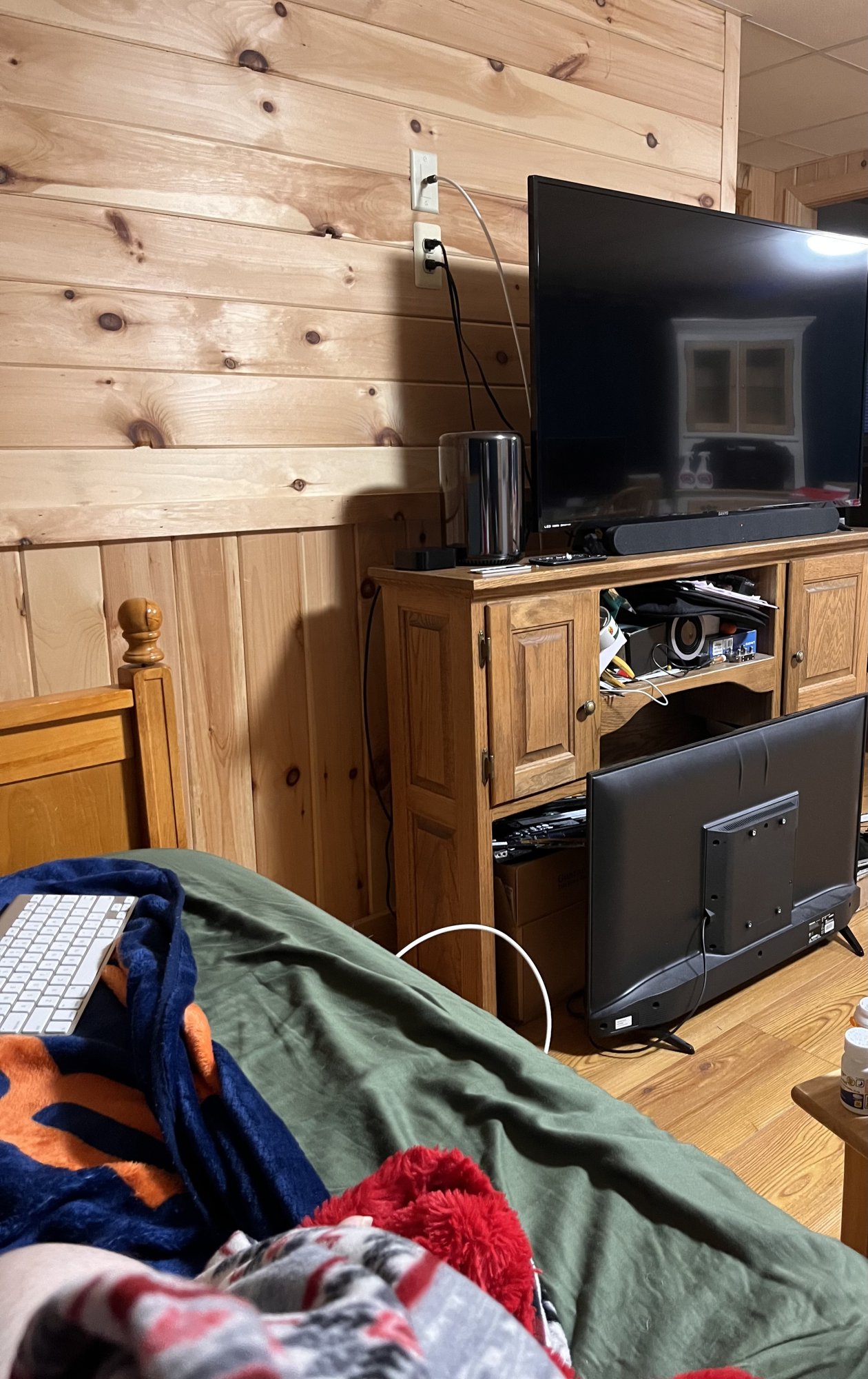

Well I’ve used all the way across the room no problem….the range is a standard AirPort Extreme that sits on a daughter board which of course sits inside the mini. It has two separate antennas that mount on top for better reception and Bluetooth….added a pic of mine…Range is pretty far….mine is behind my tv and my media center trashcan Mac Pro and I’ve used it up to 20-25 feet away. Just remember haveing miltiple devices that are Bluetooth in the same room can cause some issues at times because it’s further away from you.

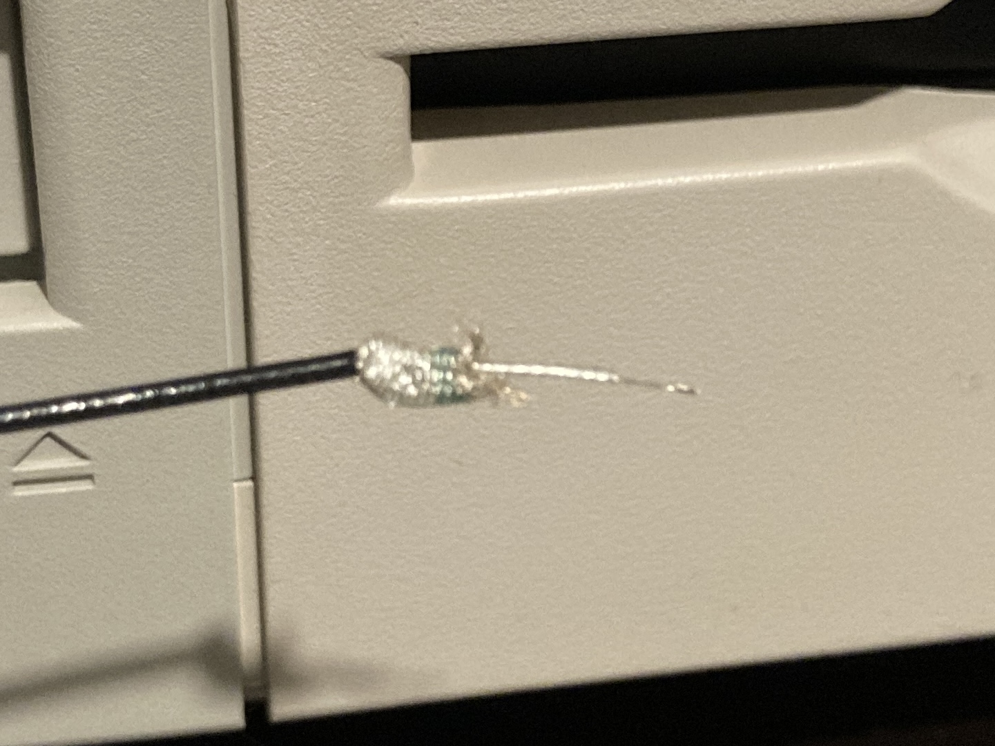

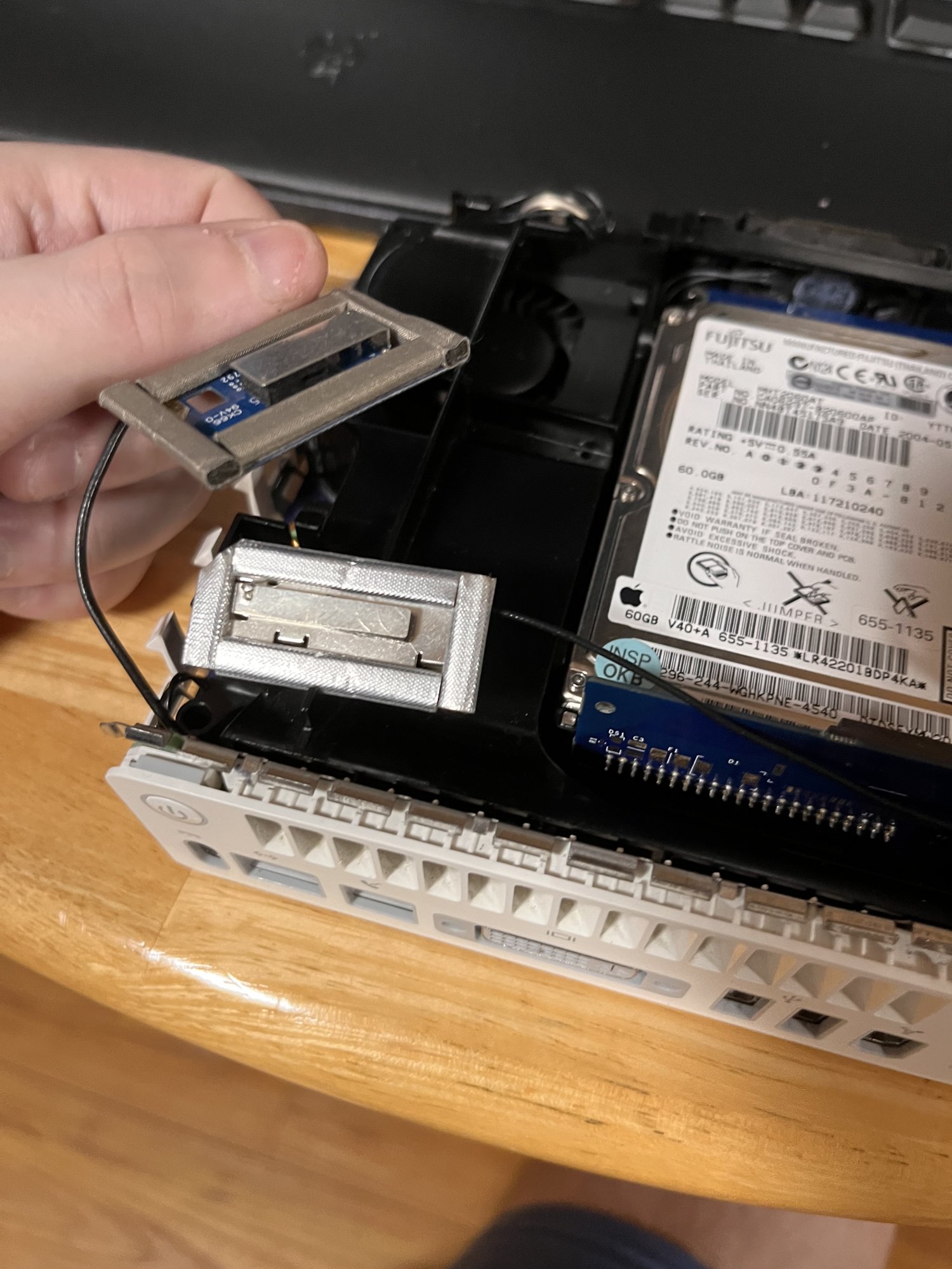

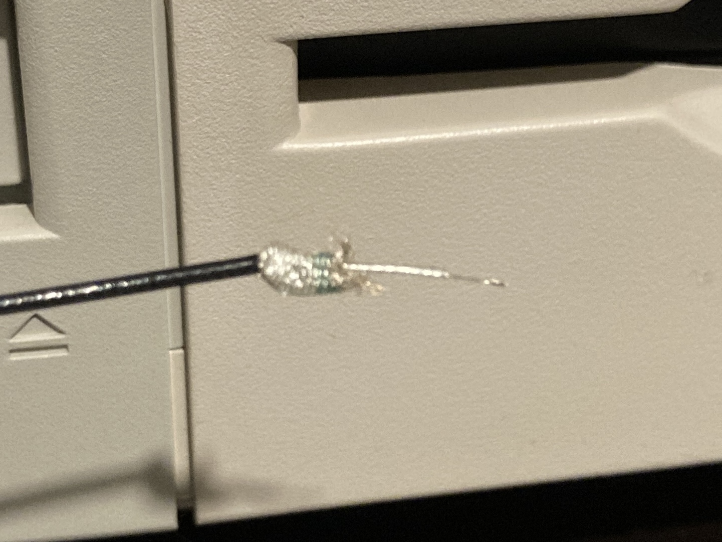

I finally got my iron out and reattached the wire to the square antenna. Keep in mind it is a coax cable. There is a very small gauge wire in the center and a sheath on the outside. These make up the two conductors.
The sheath looks like plain old nylon but it does indeed have wire in it that can be soldered.
The inner wire goes through a hole in the antenna and attaches to the top "arm" with solder. The sheath should solder to the bottom underside.
Once I got it all together I was able to enjoy Halo without lag! Finally I can use wireless devices with my old G4 Mac mini again!
