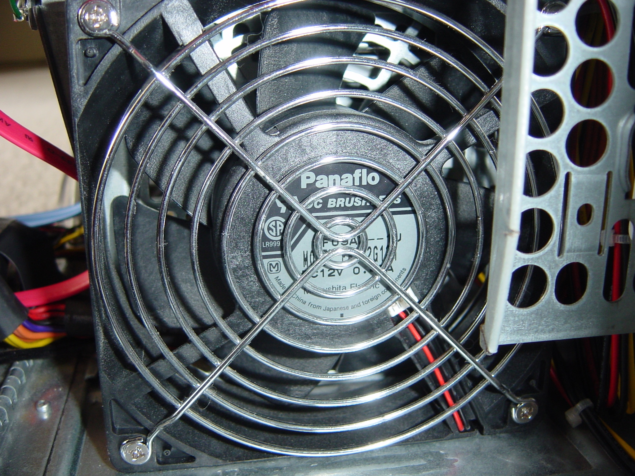

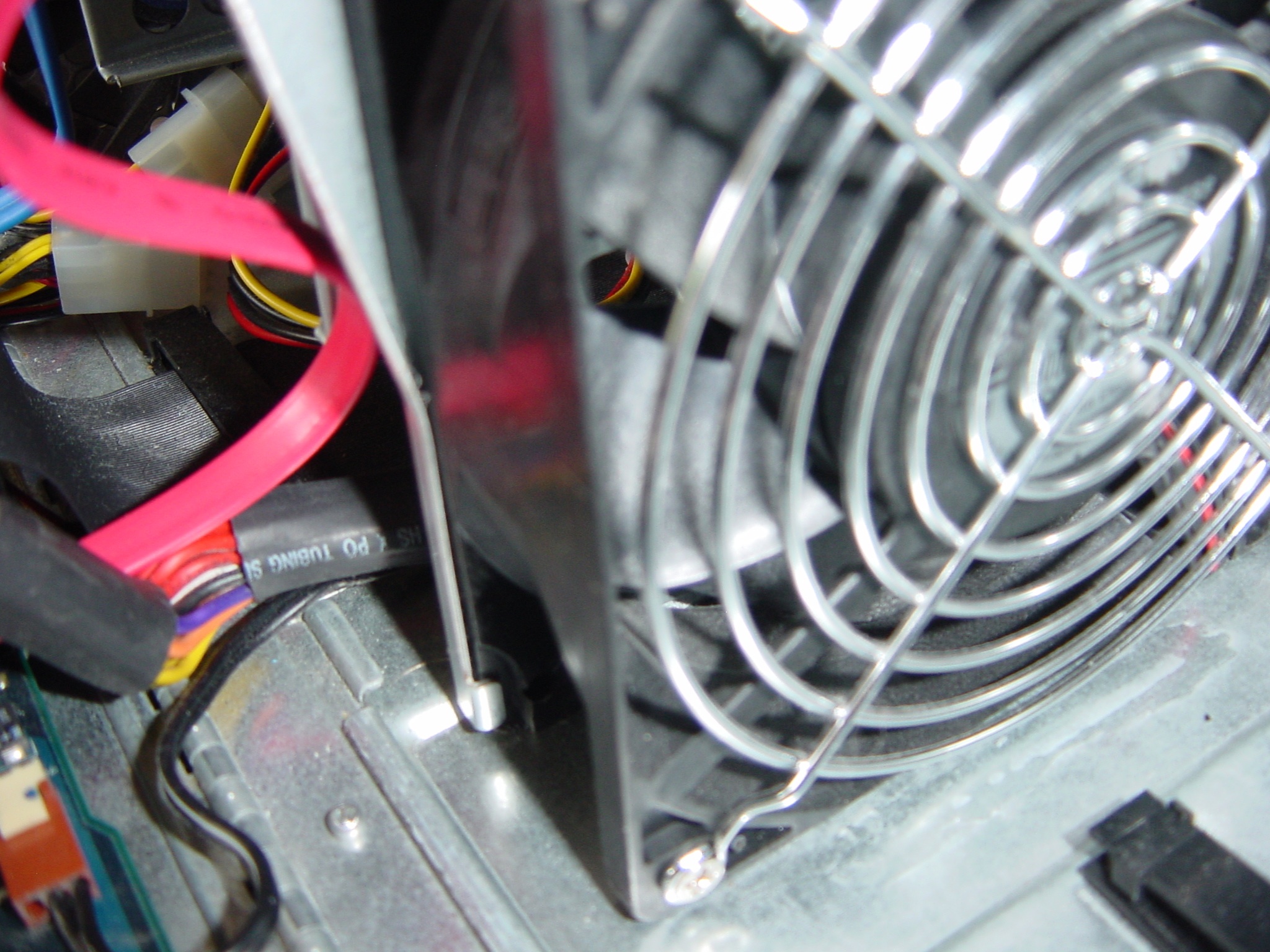

Hallo BCS,
I have replaced the original case fan in the past because of cooling and noise experiments. To replace you have three options.
1# You go with the original fan. It is a Papst model 120mm x 37mm, 12V DC, 440mA, 5.3W. You would have to order the fan or find one with equivalent values. The fan is ok, however there are less noiser ones avialble.
2# You can go with a better model, (the one I have). As far as I remember it is a fan with Hydroberaings that has less noise and better cooling. However by using this one it would rquire a small milling action with a dremel tool to make it fit since the fan is wider as the original.
3# You can go with a standard fan that you can get on every corner. They are usually much slimmer. (120mm x 25mm) These are crapy, they don't really fit and you still would need to solder the contact leads.
By the way, I have found my original Papst fan I have replaced a year ago. Its used, but it still works great. You can have it for the shipping cost.
Only thing is, you would need to solder the contact on it, but you would need to that with any solution.
Good luck
Alex :apple:

Found the one I have, it really works great. Here is the link:
http://cgi.ebay.co.uk/Panaflo-NMB-M...6356330QQihZ003QQcategoryZ80034QQcmdZViewItem
Good luck
Alex
