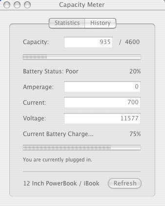

I have downloaded Capacity Meter and the following results are shown.
https://forums.macrumors.com/attachment.php?attachmentid=40242&stc=1&d=1139172326
I am a complete techno phobe when it comes to computers so any advice in "dumbed down" jargon would be really appreciated.

Another app you should run is called Coconut Battery. Go to versiontracker.com and download. I think that app lets you see how many cycles your battery has undergone. These batteries are good for about 300 cycles then you need a new battery.
As for how to calibrate, go to Apple's support web page for your powerbook.
http://docs.info.apple.com/article.html?artnum=86284
I really think you need a new battery. If you look at the results in your attachment, your battery capacity is only 935 out of 4600 amps. I'm not surprised the computer needs to be plugged in to worrk. Time for a new battery.
Good luck.

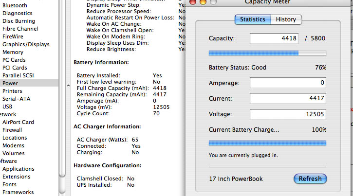

mine is like this after 70 cycles.. but about 11 months of use of the powerbook
i did calibrate once a month.. isnt this is going down to fast? or the wear is about right?
cuz if its going down this fast that means i will def. need a new battary next year...
i heard if you are using your computer by the powercore, remove the battary will help?
