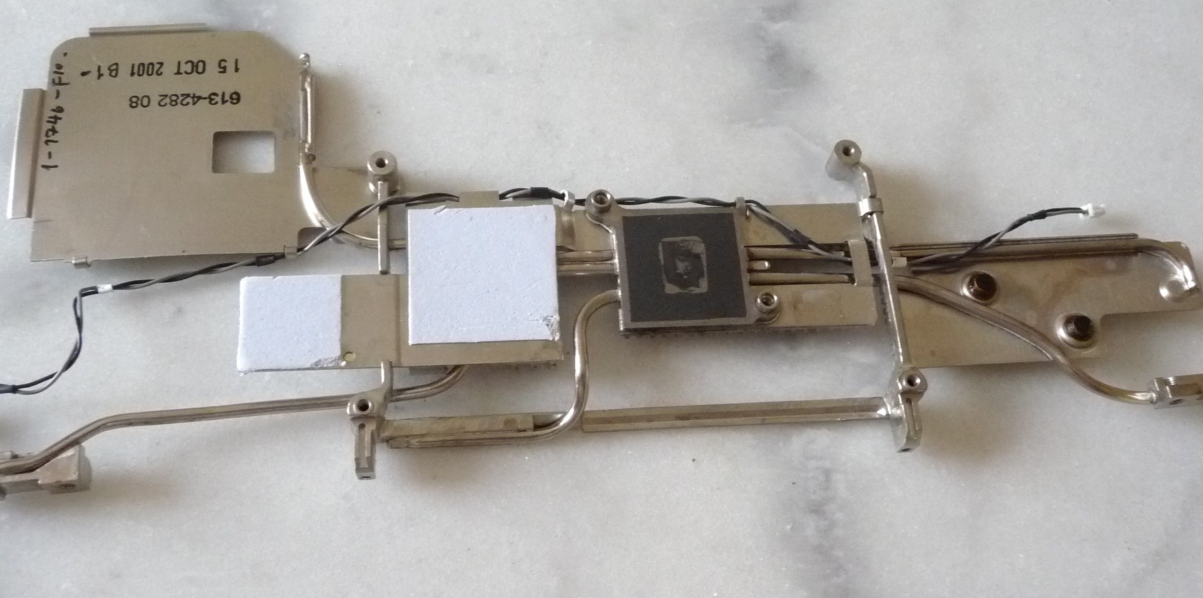

Regarding thermal paste on a G4 PowerBook Ti, I must confess that when I disassembled and re-built mine a short while ago (a 667MHz model) I didn't re-apply any thermal paste. The bottom of the computer gets pretty hot (it did that when new), fan comes on after a while, but has never had a thermal-controlled shut-down.
I've just checked my disassembly photos and note what looks like 3 possible locations on the rather large and complex heat-sink, 1 with thermal paste and 2 with thermal pads. Would it be acceptable to apply thermal paste to all three locations?

When I reassembled my 667, I just repasted the CPU
Using thermal paste instead of a pad would lead to too large of a gap between the mating surfaces to effectively conduct heat.
Interesting comment which had in fact crossed my mind.

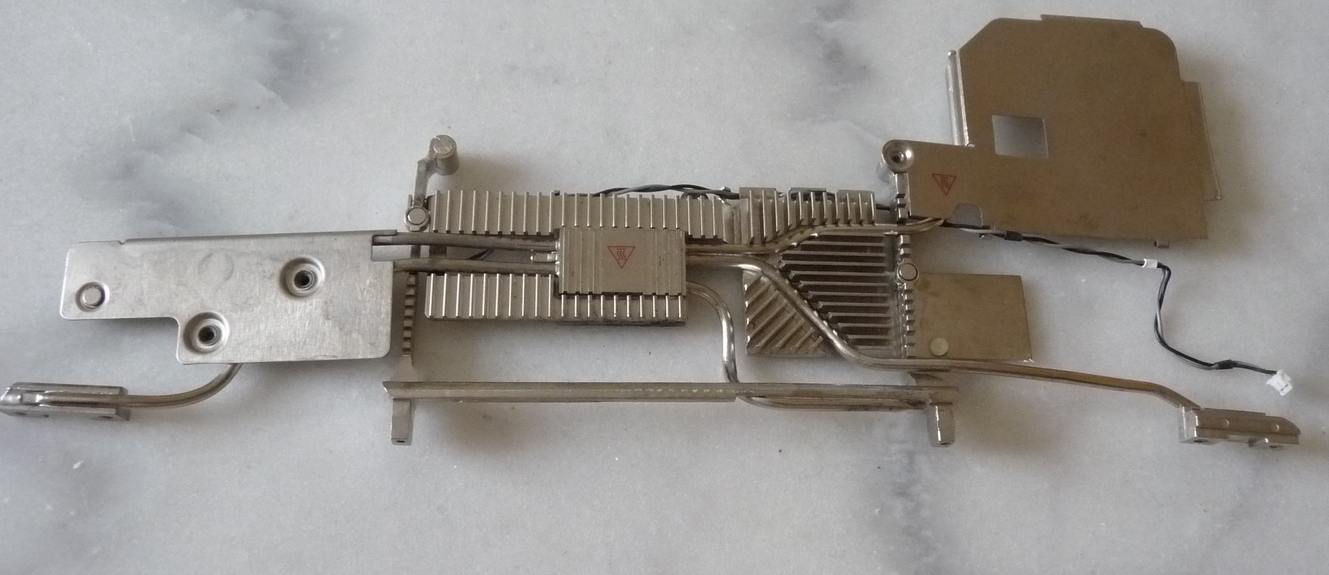

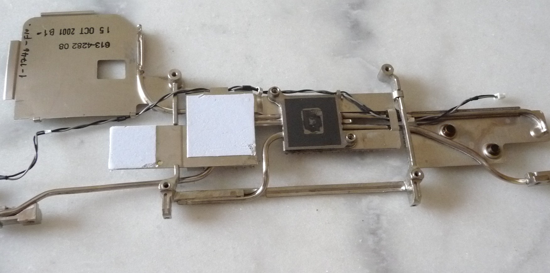

On the spare heat-sink shown above, I have just measured the thickness of the two white thermal pads (top photo). Both are 0.015"
When I next disassemble my PowerBook, if I find there are no thermal pads attached, I'll use the spare heat-sink (pads look good and not particularly crushed) and just use thermal paste on the single metal pad location.
Personally I can't see any advantage in adding thermal paste on top of pads, unless anyone has experience and comments in this respect.
I've just been reading that thermal pads are often included on the bottom of heatsinks as they are cleaner and generally easier to install. They do however conduct heat less effectively than a minimal amount of thermal grease.
This gets me thinking that in the PowerBook Ti assemblies, these pre-installed pads, in addition to their prime role to conduct heat, could well have been a precious aid in the production cycle, i.e. to speed-up assembly.
If speed of assembly is not a criteria (by us keen MacUsers), perhaps an application of thermal grease (in lieu of pads) may be an advantage. I'd have to do a few detailed height measurements of the three metallic-base locations to understand if my theory makes engineering sense.
