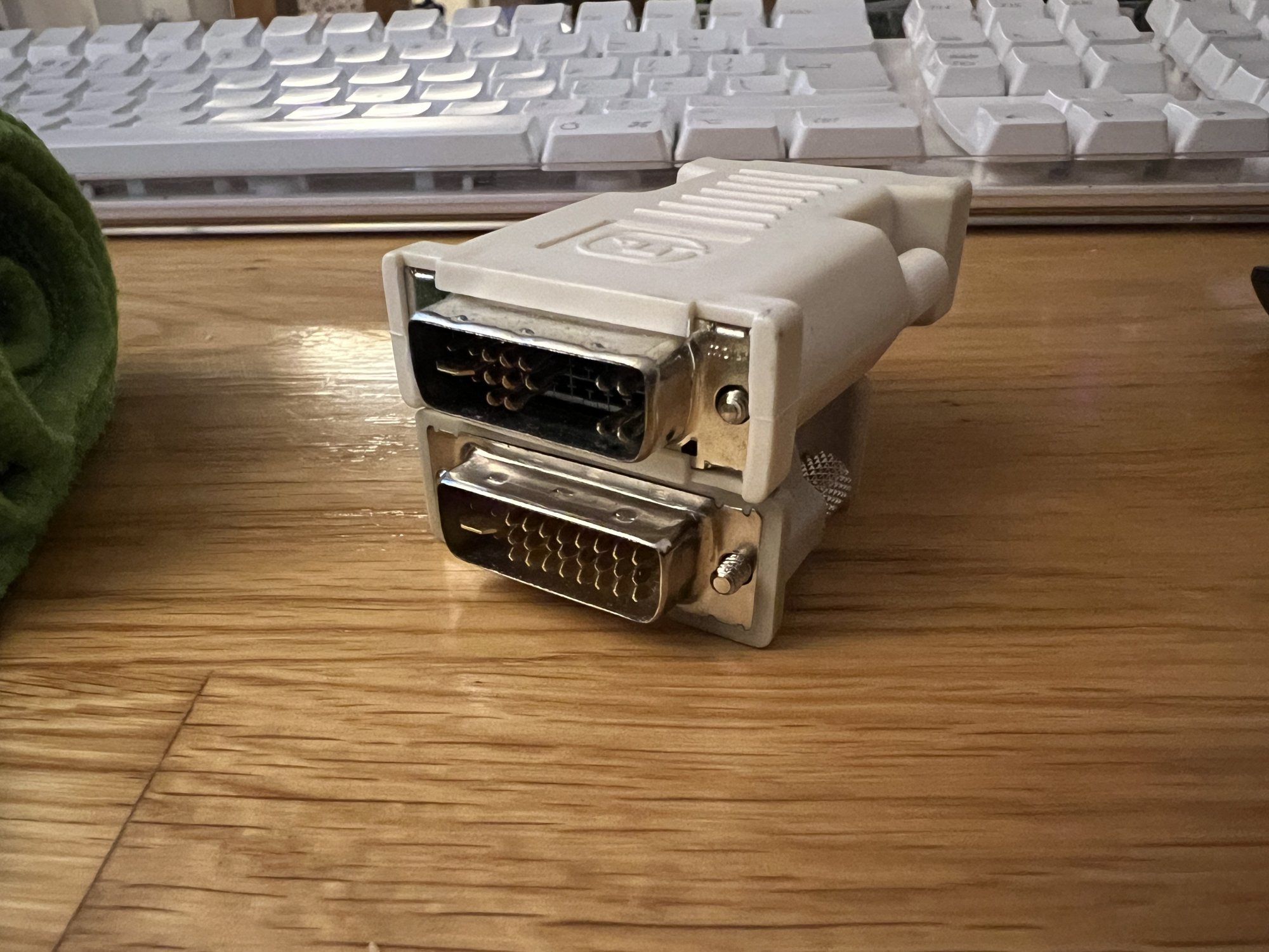

Just a quick update, the issue now seems to be resolved.
I cleaned the contacts and installed and reinstalled the GPU a few times.
Initially, it didn't seem to make a difference. However, after trying HDMI, I went to plug the DVI to VGA adapter back in and noticed that the two adapters I have were different. One has some pins missing.
I plugged in the one containing all of the pins and got the display back. I was then able to reinstall OS X Tiger. After this, the HDMI started working again too.
