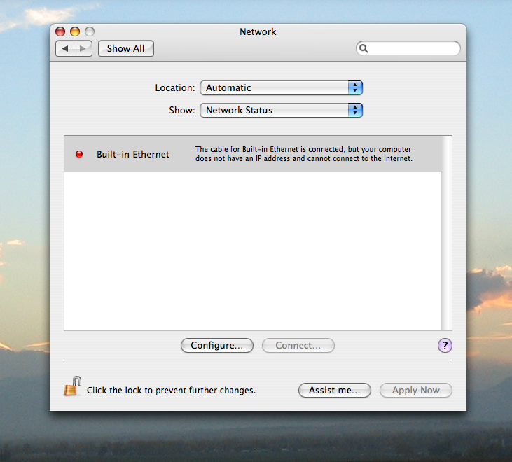

Randomly my nice old G4 PowerMac, running 10.4 stopped connecting to the internet.
Checking the Ethernet settings, it isn't seeing any information.
My cable modem and router are both fine. The router is wireless, and computers receiving the wireless signal work fine. I hooked the modem up directly to the Mac, and it still wouldn't see it.

If you can paste the following...
-Screen shots of the gui settings
-Output from this command in Terminal.app: ifconfig -a
-Output from this command in Terminal.app: cat /etc/resolve.conf
... we can then proceed with helping you.

<my name>-power-mac-g4:~ keith$ ifconfig -a
lo0: flags=8049<UP,LOOPBACK,RUNNING,MULTICAST> mtu 16384
inet 127.0.0.1 netmask 0xff000000
inet6 ::1 prefixlen 128
inet6 fe80::1%lo0 prefixlen 64 scopeid 0x1
gif0: flags=8010<POINTOPOINT,MULTICAST> mtu 1280
stf0: flags=0<> mtu 1280
en0: flags=8863<UP,BROADCAST,SMART,RUNNING,SIMPLEX,MULTICAST> mtu 1500
inet6 fe80::203:93ff:febd:7f2c%en0 prefixlen 64 scopeid 0x4
ether 00:03:93:bd:7f:2c
media: autoselect (100baseTX <full-duplex>) status: active
supported media: none autoselect 10baseT/UTP <half-duplex> 10baseT/UTP <full-duplex> 10baseT/UTP <full-duplex,hw-loopback> 100baseTX <half-duplex> 100baseTX <full-duplex> 100baseTX <full-duplex,hw-loopback> 1000baseT <full-duplex> 1000baseT <full-duplex,hw-loopback> 1000baseT <full-duplex,flow-control> 1000baseT <full-duplex,flow-control,hw-loopback>
fw0: flags=8863<UP,BROADCAST,SMART,RUNNING,SIMPLEX,MULTICAST> mtu 2030
lladdr 00:03:93:ff:fe:bd:7f:2c
media: autoselect <full-duplex> status: inactive
supported media: autoselect <full-duplex>
<my name>-power-mac-g4:~ keith$ cat /etc/resolve.conf
cat: /etc/resolve.conf: No such file or directory
